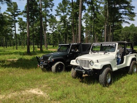

Heres a picture of my LJ with my Lift already one it, cant find any photos when it was stock

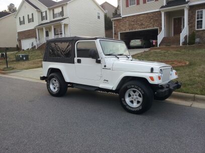

My first thing that I did with it was put HID lights in it. As you TJ owners know, the headlights and mostly seal beam bulbs so I had to guy the H4 conversion head lights that I got from AutoZone for just under $100 and then got my HID H4 kit from a guy on Ebay that I have bought all my HID kits from. HID kit was just under $30. They are H4 bulbs and color is 6000k(which is a whiteish/ blue color)

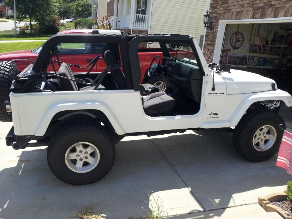

Then it was time to have fun so that I can do more extreme off roading and mudding. I did a 2.5" RC suspension lift with a 1.25" RC body lift. Did all the work my self and got the lift for just around $350 off extremeterrain.com. Saved about $1200 installing the lift with my buddy.

And then of course after getting the lift on I had to go and have 33x10.50 BFG Mud Terrain tires!!
