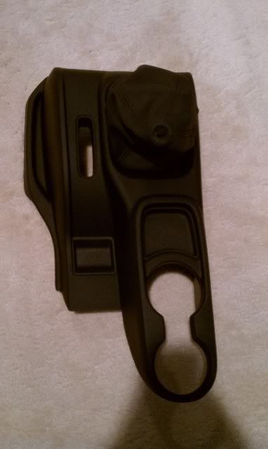

Lastly, pop off the top of the center console. First, grab the shift knobs and pull them straight off. I found it convenient to sit on the center arm rest since the seats are out. I pulled the 4WD lever back for a better angle.
I forgot to take a pic of the console section, but here's one from another thread.
