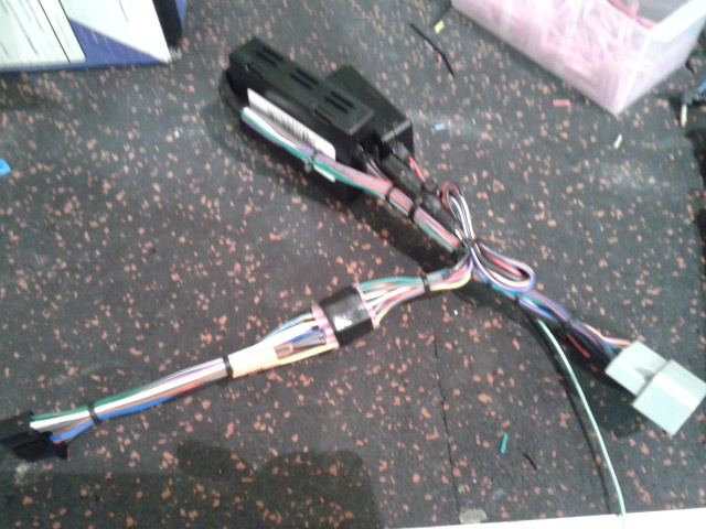

Moving on to the benchwire of the harnesses. It's important to familiarize yourself with the manuals for the wiring harness as well as the new radio. I will go over a few pointers to keep in mind, but I will assume you know how to match wire colors and connect accordingly.
  • The CHTO harness provides a Reverse gear signal output, a Vehicle Speed Sense output, and a Parking brake output in addition to the standard stereo wires. I used the reverse gear output so that the Kenwood would display the back-up screen automatically upon shifting into reverse. The Kenwood unit does not have a VSS input, so that was not used, and I chose to wire the parking brake input of the Kenwood directly to ground to bypass the video interlock.
  • There are two red ACC outputs on the CHTO harness - I used one for the Kenwood's turn on, and the other I split to turn on the ASWC and the back-up camera.
  • The CHTO comes with two vehicle-end connectors - be sure you begin your bench-wire with the correct one for your Jeep. Take the original radio out first and verify which plug you will need.
The CHTO harness/module. The two grey plugs are the vehicle ends; be sure to use the right one!
