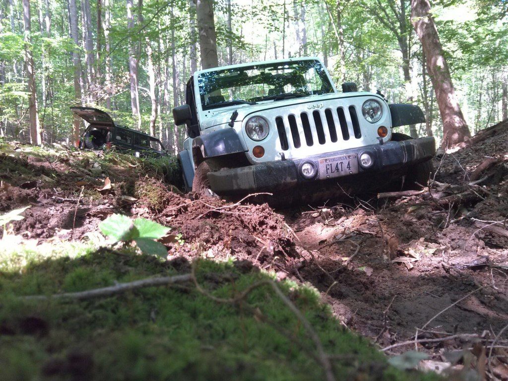

Ok, so here is an update. I decided to make a couple of new trails on my property to test the jeeps ability. I have 6.5 acres in dale city. so why not. I strictly was using 4 wheel low, and I am much happier with the crawling speed of it. What are the downside of using 4 wheel low on the regular for off roading. I have always been a ( only use 4 wheel drive when 2 wheel gets ya stuck) kinda driver.
1,504 Posts
There is little downside of using 4 low over 4 high other than the top speed you can run in each gear. The other piece of that is that you can't shift from 4 low into 4 high without stopping. On my Jeep, the transfer cases whines some in 4 low, but that is to be expected.
If you are feathering your clutch to go slow off road at 10MPH, you should be in 4 low. If the trail permits, I will start in 3rd gear in 4 low as long as I don't have to feather the clutch. As mentioned above, you get get up to perhaps 40 MPH in low range anyway. It doesn't hurt to stop, shift into 4 low to clear the obsticle, then go back to 4 high. I'd never drive in 4 high until I got stuck... I'd get stuck a lot if I drove that way.
