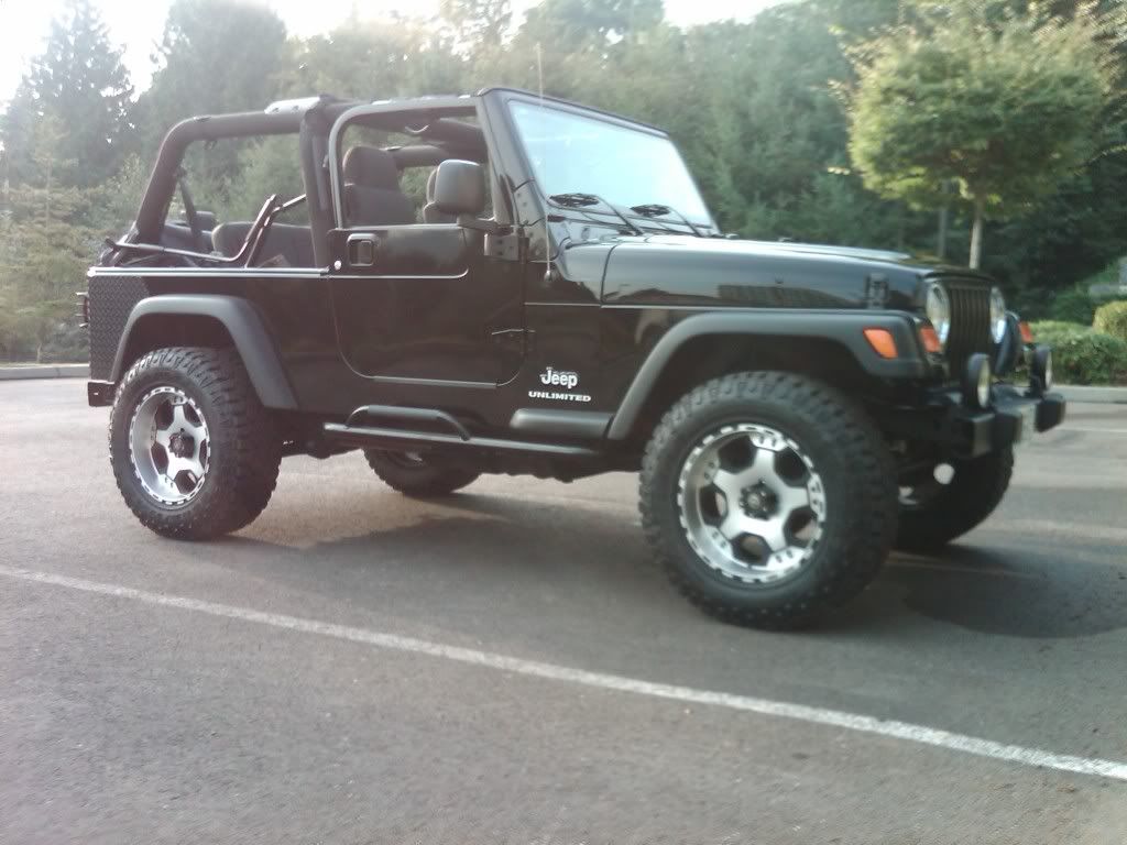

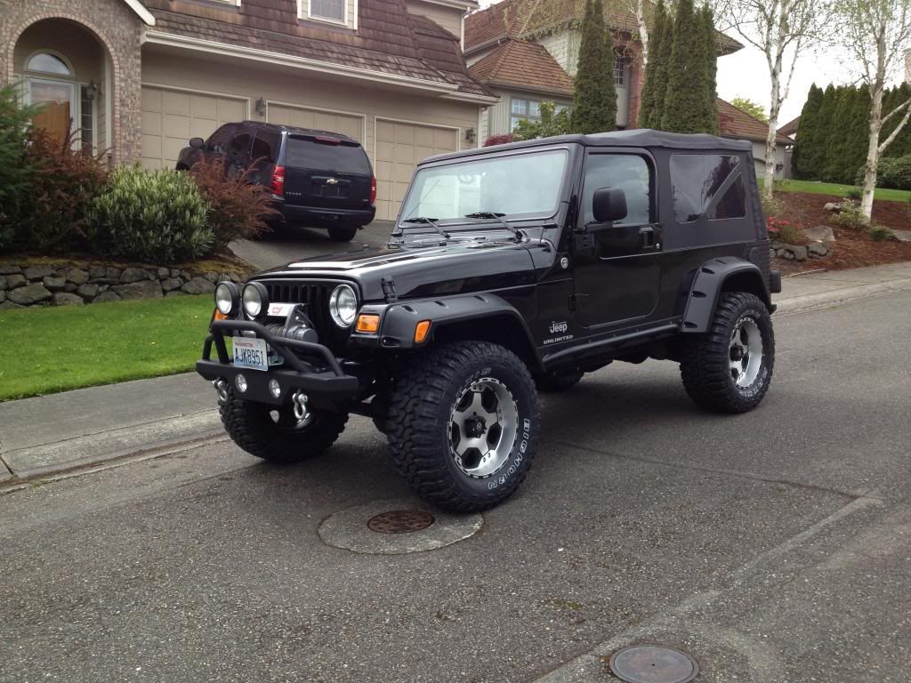

If you’re driving mostly street, and you’re on a budget, you don't need to spend huge money on suspension and axles. 3" of lift will be fine for 33s, you can get that cheaply with a 2” budget boost and 1” suspension lift for a couple hundred dollars, and a set of tires and wheels for $1,500 or so. So for around $2K, you’ll be good to go. You could go for 32s and just the 2” budget boost as well. This looks very good, not that much different than 33s.
This was my LJ with 2” lift and 32s:
Today with 3.5” lift and 33s:
