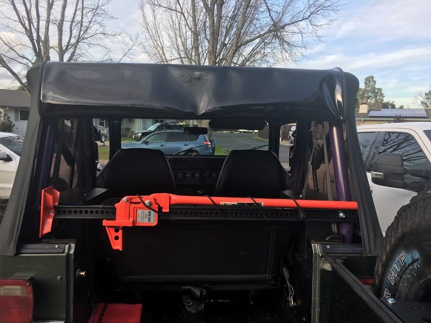

Not knowing when the right tire carrier will come along I decided to temporary mount the farm jack....
Yes, it will take a couple minutes to remove (same for the piece of [email protected]*t thief) but I like the location. Out of the weather in winter and snug inside the tub in the summer..
Used (2) 2 3/4 muffler clamps, two extra 1/2 lock nuts, 2 larger washers & lock washers,
Once I set the height, I had to drill out the hole on the farm jack base to match the u-bolt for the clamp. I just snugged up the clamp, placed the jack in place and then used the level to make it all level. When I got the right height, I just locked the clamp down, added a nut and washer behind the jack base and arm, then added a lock nut and tightened both the top and bottom down... Done
Not the fanciest or ideal... but its cheap, secure and somewhat of a security piece of mind...
inside and rear view
Reactions: YJ94S

Not a bad place to mount the jack at all, I like it!
Thank you
If I don't get the tire carrier as soon as I plan to, I will swap out to a wing nut set up when I am on the trail...... this way it will be a tad quicker if I need the jack, but I never really anticipate using it.... but the minute you need it and don't have one.... well you know
