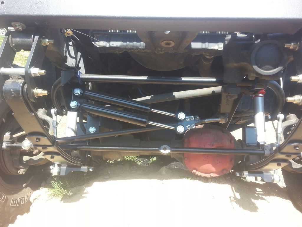

Installation of the lift took some time but I am particular and make sure everything was tightened per specs. Everything bolted right up except a few mods that were expected. I am satisfied with the end result. Cant wait for the next project. Hope you enjoy the pics. I wanted to post this project somewhere so others would know, just in case they were trying to decide what suspension lift to go with. Rough Country is the best option for the money and has well made product and parts.

Cardwell, are your front Shackles on backwards, or Mine on backwards, because we have them on in the Opposite way?

Good eye ! I over looked that his front shackles are on backwards and upside down.
In the picture below you will see how they should be facing in the front, How you have them on the rear is the proper orientation for the rear
