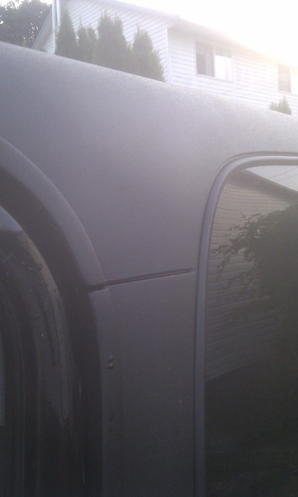

A couple guys asked in another thread to see pics of my hardtop that I bedlined so I figure I'd make its own thread
I had some chipping issues on the paint and I had done my fenders, mirrors etc already so wanted to spray it even though it was going to be basically the same colour :rofl:

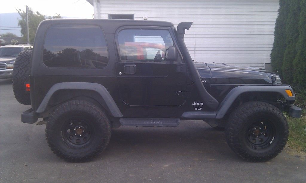

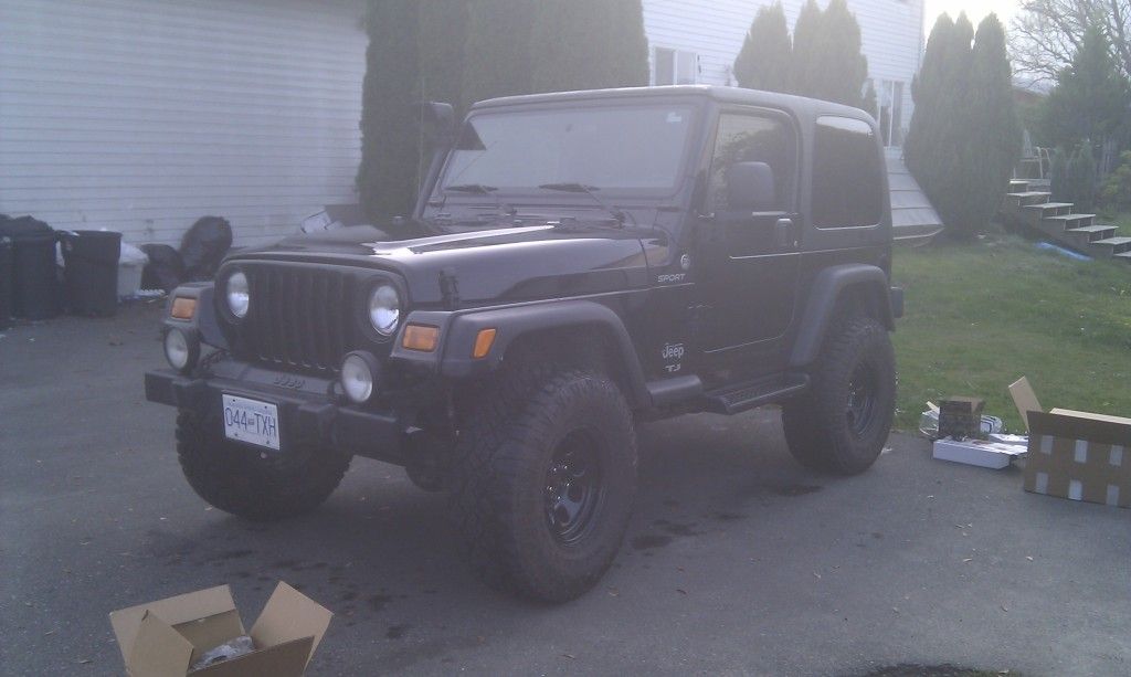

Before:
Prep: Sanded with 80 grit, 150 then 220, blew off the dust and wiped it down. used approx. 4 1/2 cans rustoleum bedliner.

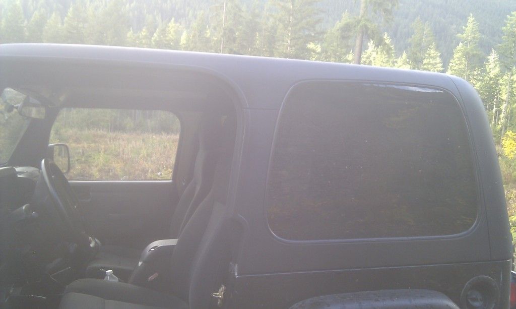

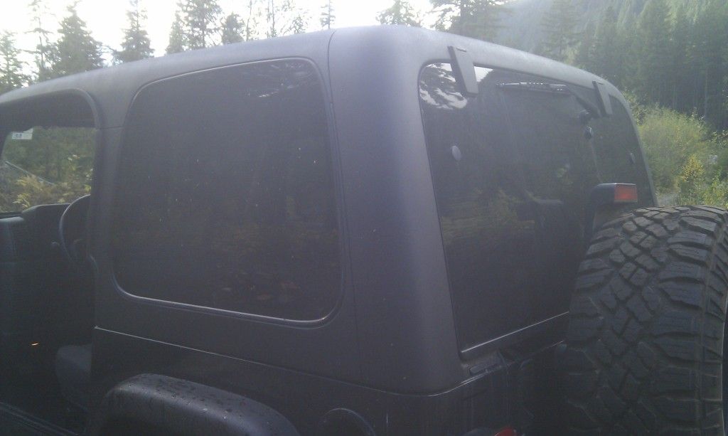

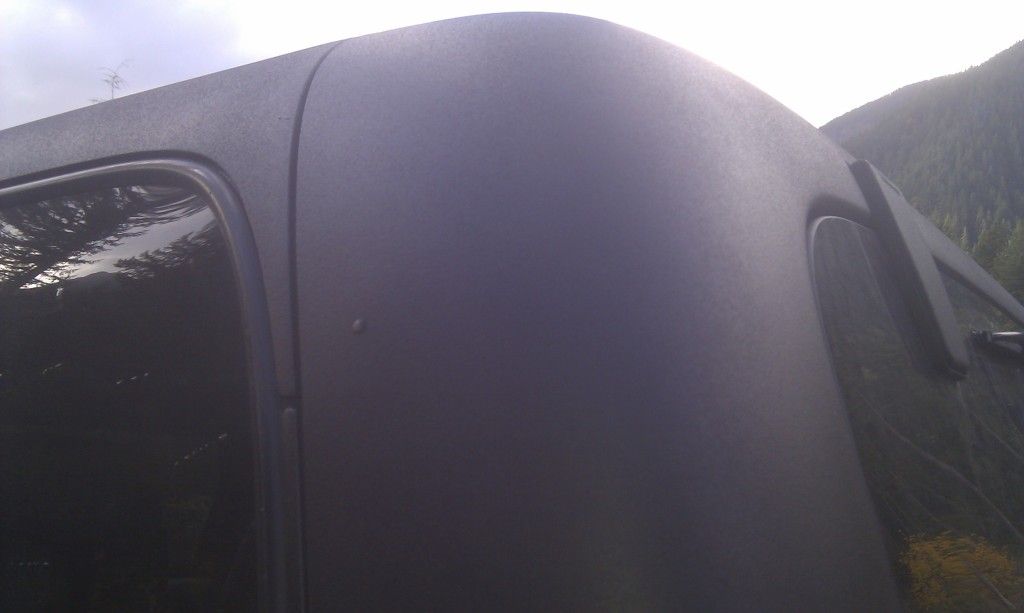

Finished result:
Forgive me if there is any mud on these last couple pics, it hasn't rained here in a long time and I found a huge puddle on the way to shooting and yeah haha you know what happened, i figure i better get a couple pics before I really soaked it
I coated 2 layers, then sanded down a coupe runs, drips and dead flies that decided they wanted to land on it and gave it one more. Any bumps on the pics are water or mud, there is virtually no imperfections, came out very clean and smooth, really happy with it :thumb:

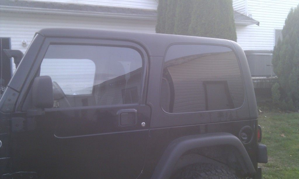

Mudsearcher77 was thinking about doing his, i took another pic approx same angle

Looks good. I recently did my front grille with the rustoleum bedliner and love it. Only thing is it seems to be kinda rough and it seems to attract bugs like velcro. I am debating on using the bedliner or krylon but it won't be until spring. I waited to long this year to make up my mind. Anyways let us know how it holds up.

How thick were your coats? Did you start with one light coat, or just go for as much coverage as possible right away?
How much weight did this add? Did u take the windows out? Did U spray the inside?
weight? wut is dis wayht?
Light coats, learned it was better from spraying everything else :) I found when I tried to use thicker coats it tended to sag/run. The actual spraying took the least amount of time involved in the project so it wasn't that hard to be patient with.
Not enough weight to notice anything. Take a full can minus the empty can and it might be a 1/2 lb per can. Plus you get to subtract all the old paint I took off, and there was a lot. I masked off the windows with tape and newspaper. I didn't spray the inside. It was white inside and the paint wasn't flaking there, I was worried it would be too dark/dreary inside.
Bed lined the outside ,painted the inside ,i like this better than white.
