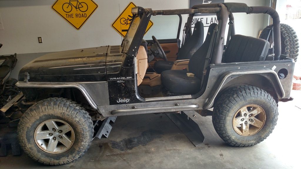

I placed the order on 01/26 for hoodline fenders, rear flares, and corner guards. I emailed Chris Dennis with CCF and was advised that they would ship Feb 2nd, but they did not ship out until Feb 11th. Then the rear corners and fenders were shipped Feb 18th. Keep this in mind when placing your order. It took exactly 1 month to receive my fenders and corners.
I tore my jeep apart as soon as the front fenders arrived anticipating the rears to arrive shortly faster, but I was wrong. Plan on having your rig down for some time. My understanding is that they make the items after the order is placed. It takes a bit longer, but gives you the opportunity to make changes if you want something different. (See Below)

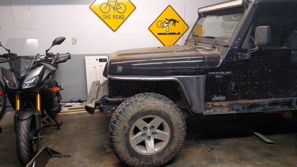

Front fenders :
The fenders looked great other than a couple small imperfections. They bolted right up with no modification to the fender themselves. If you follow the instructions the install process is very straight forward and I had the first one on within 30-45 minutes. All of the welding looked great except for the underside where they only spot-welded the sheet metal to the tubing, but then again it isn't structural so it's not really important. Most companies do not weld it 100% so I wouldn't call this a negative, but more of a observation. The one think that I did not like about their instructions is that they advise to cut the last 11"; of the rain lip out from the top of the old fender. I cut originally per the instructions and realized how crappy that looks so on the other side I left in place it it made for a much cleaner install. It will not bolt to the front of the tub, but then again who cares.
Everything seemed to line up great, other than the bottom of the fender where it meets the body. I tried for an hour or so to get the fender to slide down far enough to go flush with the bottom of the tub, but no luck. Rock sliders cover this up anyway if you are running sliders so not a huge issue either. I later realized that if you were to get them to slide down then the hoodline will be off hy quite a bit.
These are called hoodlines, but in reality I would call them a modified hoodline. The fender does not bend inwards to the hood once it comes up. It runs parallel to the body for a bit and then turns and follows the hood. I assume it is done this way since the bend is easier, but if you are looking for a hoodline similar to a Genright this is not it. Does it look bad? No, but it isnt what I call a hoodline, so be sure you look at the pictures and make sure you like the bends before ordering.

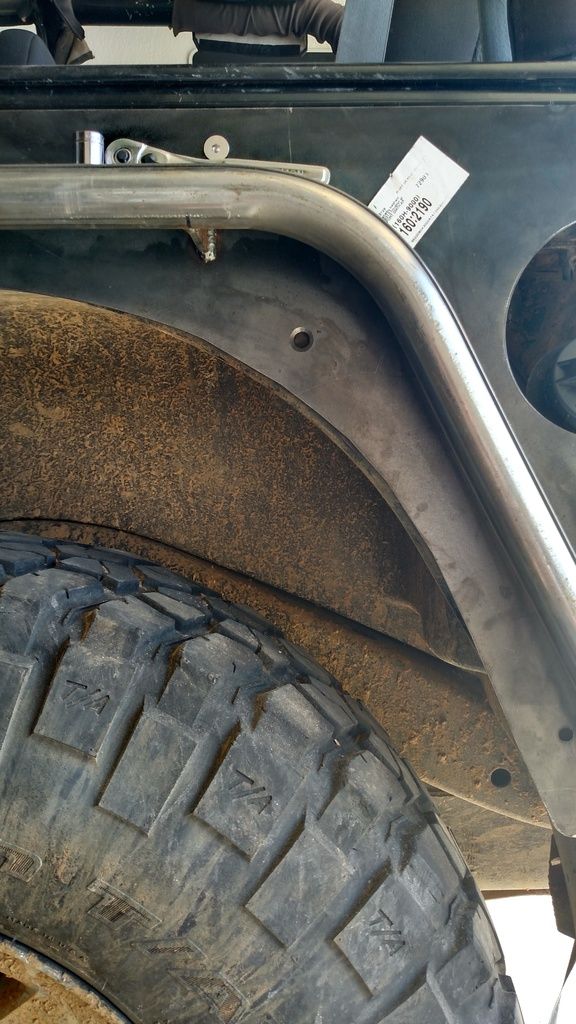

I am combining this section because CCF does something that I have not seen before. They actually welded the corner armor and fenders together. Some may like this, and some may not. After my conversation with Chris is appears that if you order both they weld them together. If you order one or the other they bolt together. The website does not specify this, and I did not find out until they arrived at my door. You will want to be sure to specify what you want when you order. They do not mention anything about the option on the website.
I ran into several problems since they were welded together. First off you cannot do 2 tone paint or powder coat since the tape line would have to be on the weld line and you cannot get a nice line over the rough welds. I was planning on doing the corner armor gloss black powder coat so it would match the body, and the corner armor satin. Unfortunately once I received the armor those plans had to change. Secondly with the fender already mounted it causes problems when you go to cut the corners for rocker guards. Generally you can just tape the corner armor off and cut it to fit, and then bolt the fender over the top of the rocker and corner armor, In the case of CCF you have to cut around the fender, and actually remove the bracing at the bottom of the fender. In the event that you need to remove a rocker in the future you will have to completely remove the corner armor in order to remove the rocker. Once you remove the bracing you will have to reweld the tab in the bottom of the fender for bracing, and then drill and tap your rocker guards so you can bolt it down. If you don't run rocker armor then you will have a gap between the fender and the body. The lower part of the front of the fender was also wider than it should be so I had to cut part of it off to fit with the body. It should have been 3/16 off from the body based on how it comes down from the tub, but mine was more like 1/16"; off from the tub at the bottom and 3/16 off at the top. The fender placement also seemed to be off and left a large gap between the actual fender liner and the tube fenders. I would have preferred if the top of the fender was 1" ; lower, but that is just personal preference. Pic after it was trimmed up, and rewelded.

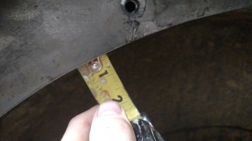

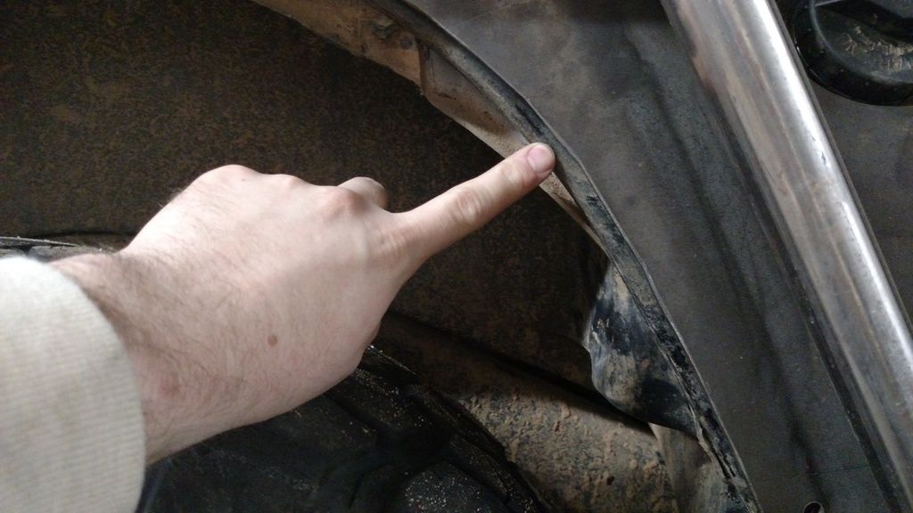

The wheel arch radius was off by as much as ¾ of an inch in places on both sides. On the front part the arch the corner armor actually extends ½ " past the body. 10 oclock to 1 oclock actually shows 1/4" of the body that is unprotected, and 1-2 oclock has up to 3/4"; of the armor sticking past the body. ( was able to trim this to match the 1/4" so it would look better and more uniform. The radius was not cut to line up with the body line. Some spots the tire will hit, and some the armor doesn't protect the body. Seems like this would be simple for CCF to correct on the laser drawings, but is difficult for an end user like myself to correct. If you are going to cut the tub and remove the fender liner then this will be a mute issue, but if you want to run the fender liner and not cut the tub it is something to consider. I ended up trimming the corner armor the best I could and running it.

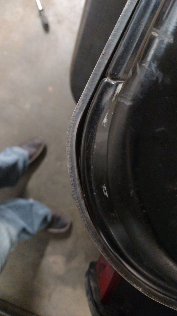

The corner bend on the corner guard was off as well. It appears that they made multiple small bends in the middle, but on the first bend in either direction was quite drastic and pronounced. It leaves a space between the body and the armor. Enough space that i can see daylight throught it. I understand that this bend is complicated, and typically involves a multitude of bends in order to get it correct. It appears that they did far fewer bends and 2 drastic bends on either end in order to save time on bending them. The middle of the bend is too flat. The level of quality shows up. This causes the taillight area of the armor to bow out from the body when you put it on since the bend is not tight enough to fit the body line properly. With enough force and clamps I was able to get the drivers side to bolt down, but you will need large enough washers to keep the bolts from bending the body of the TJ. The passenger side corner was about the same, but it wouldn't bolt up without the use of a press to rebend the corner. The end of the armor by the gate hinge was 1/2+ off from the body and that was after doing everything I could to clamp it down. The notches around the gate hinges were also off a little. The top fit fine, but had a large space around the hinge. The lower cutout was super tight on the top of the hinge and needed some trimming to get it to fit. Not a very uniform fit.
