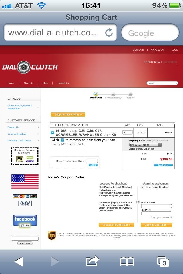

I got the same clutch that dialaclutch wanted 210 bucks for off of eBay for 122 to my door.
$210 from Dialaclutch? That's odd, $155 is what Dialaclutch charges on their website for the 05-065 TJ clutch kit. If you priced the Luk Gold kit which is more $$$, that's not the recommended Luk model clutch.
$155 plus $60 for shipping to Oregon from wherever they are.
Edit not $60 but $41
