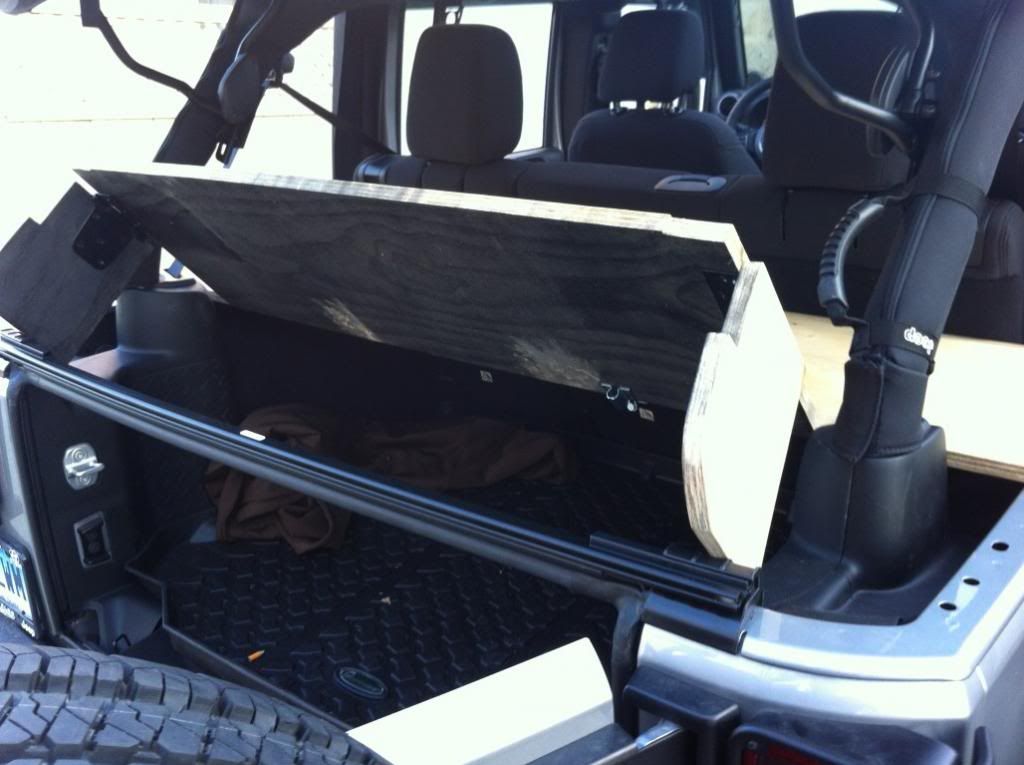

Now, I should mention that I didn't want to not lose all of my storage capabilities and I figured if I put some hinges in my trunk I could flip it back and have more storage when I needed it, especially for some larger, standing items.
Using my cardboard cutouts and a lot of quarter-inch by quarter-inch trimming I was able to construct the front section of the trunk out of the second plank of wood. The rounded corners were the hardest part. I had to constantly test out the fit because I wanted to be able to flip my trunk up when I needed to regardless if I had the soft top on or not. Pictures are always better than words so here ya go:
^^^Take note of the hinges I placed on the sides of the corner pieces and that they can be folded it and then fit in between the soft top brackets when the trunk is flipped in for the extra storage. Also the notches in the front most part of the wood. The notches are where the brackets are on the body that hold the lower rear window frame. The lower rear window frame will be needed to completely close off and not allow any access to the secured storage area.
Here are some shots with the rear window frame in use with the trunk and one shot I took when the soft top completely enclosed around the trunk:

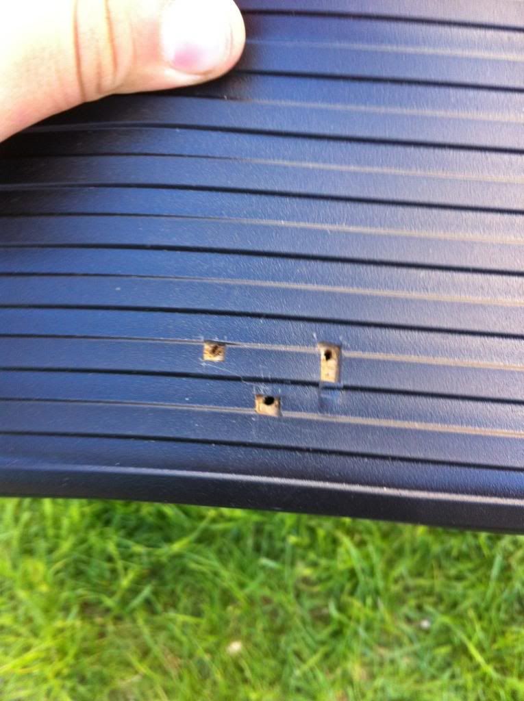

Now to talk about covering the wood. I wanted something that could handle getting wet from the rain so carpet was out of the question. I toyed with a couple of ideas. First thought was plasti dipping, but I just didn't like the way the plasti dip felt on the wood and not to mention this thing would bake in the sun as well as getting abused from tools and other objects getting placed on top of the trunk. I ended up getting two rolls of this plastic/rubber mat from home dept. I cannot find the exact product right now but you can buy it by the foot or in smaller rolls. I cut and treated this material as if I was upholstering a piece of furniture. I used a staple gun to secure it to the wood. I used a drill with a small bit to mark all of holes and would cut out small squares around the holes so I could get the various screws through the wood after the at was completely attached to the wood. Upclose picture of material and cutouts I would make for the holes:
The material was a bit tough to work with, getting it taut and such. I found leaving it in the sunlight really did help out with being able to manipulate it as needed. Was I mistakenly did not account for was how thick material was and it did add some bulk though all around the wood; though not enough to ruin the fit of the trunk on the body. It did take some pressure and squeezing to get everything to fit just right and have the pre-drilled holes line up perfectly for the hinges and hasps.
I should note that I did file down the screws that did poke through the wood. Again, this wood is only .75in thick so I had a lot of sawing and filing to do to these screws. This was pretty time consuming as I think about it now.
