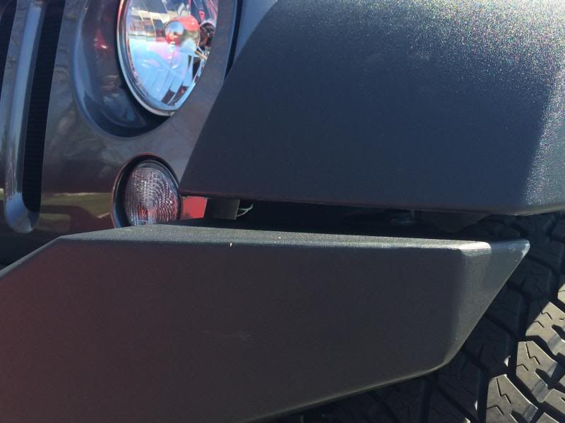

So I couldn't decide whether this thread belonged here on in the JK Tech forum; but I settled on this one. I sifted through several searches and couldn't find exactly what I was looking for; I figured that some, if not many, have encountered this issue after bumping into something off road. Basically, I rubbed up against a tree with my front passenger side fender flare. It now sags down and I'd like to re-align it. Have any of you had this occur? What is the common remedy/issue. I have had the clips all replaced and it improved the problem, but as you can see, it is still sagging. Could it be the metal support arm? The plastic support piece? Insights?

Did you leave it parked with something heavy on it to warp the plastic?
Have you checked to see that all the clips are installed and none have broken? I remember someone posting at one time that they didn't have the correct amount of clips installed from the factory...

Vacca, it is pretty darn solid. After I bumped the tree, clips were off. I had that re-done but it only improved the situation...
392 Posts
I hit a trash can at about 45mph and did something similar to mine. In my case the welds were broke on the metal arm and it was bent down (but still attached).
392 Posts
That would be the only way to fix it. I installed Smittybilt flat flares that do not attach to this bracket. I just kinda bent mine back up and left it.
32 Posts
You probably need to have the fender liner replaced or the metal bracket that supports the fender in place bent back up.
