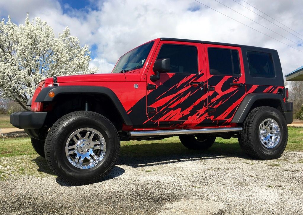

I need some help here. I had a 4" Skyjacker lift with adjustable control arms F&R, Track Bar brackets, etc. It was simply too darn high, so I ordered a Rough Country 2.5 inch shock and spring lift. Had a local shop do the swap and alignment and my front is still at 4". The alignment came back OK (so they said, I didn't get a printout). One thing I know they didn't do is adjust my track bar. the front is OK (another sign I haven't lowered there), but the rear is shifted to the Driver side. I am taking it back in today to have them move the track bar to the middle hole of the TB bracket to hopefully fix. If not, I will get an adjustable track bar. I have attached a pic.
I really question whether these guys knew what they were doing or did I get the wrong front spring set?

Wow. Looks as if the springs weren't changed in front. Track bar would just throw the axle off to one side a lot.
Being that the shop didn't mention any of it to you, I'd say use someone else if you can't do it yourself. They should've said, "hey man...we put this stuff in, but...". At least that's my opinion.

Yea. I'm going back today and will take a better look. I am using the track bar brackets that were on the 4" lift. The rear bracket has two positions and based on the part number it is for 2" or 4" lifts, so moving that position should be fine. The front has only one position, so once it is at the correct height, I may need an adjustable track bar.

Wow...I thought the springs were wrong (and Ken). Sorry to hear you got hosed for install $$ twice. If I were the shop, I wouldn't make you eat it...at least discount the second time. I feel like they are partly responsible because in their position they should have known (and probably did know) the front springs were wrong, and notified you before proceeding further.

So the shop is actually going to cut me a deal. They had a suspicion they were the wrong front springs, but since they don't swap for height on a regular basis, I don't blame them for going with what was clearly sent by the manufacturer. I inspected the box myself and it was clearly marked as what I ordered. When I called Rough Country, the guy initially thought I was wrong, but when he had me measure the spring height installed, he knew they messed up and said they would ship the parts out ASAP. I'm scheduled to have it fixed Saturday, as long as the parts get here.
