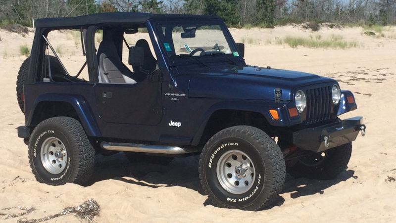

Thank you in advance for the help. Within the next month I will be swapping out my current 3.07 geared axles with a set of 4.10 geared axles (rear being a Dana 44). I will be using a friends lift to do the work with the assistance of him. He is mechanically inclined so I do not foresee any issues with the swap, but I want to ensure while we are in there that I replace what I should while having it apart. I have a 3.5" lift that I installed 10 years ago so it's time to replace the shocks, (I ordered new Rubicon Express shocks), new gaskets for the differentials, speedo gear for my tire/gear ratio size, fluids, etc. Brakes are all recently replaced. Is there anything major that I am missing/should do while I am in there? I also do not want to show up and be missing an obvious part and stall the swap. As stated before thanks for the help.
1997 Wrangler Sport w/ 4.0L and 5 Speed if that helps any.
