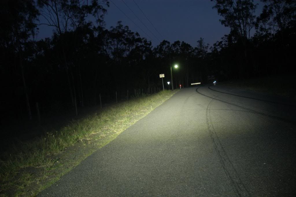

HI Yes, Im testing Australia so using the H4 euro JK Lights, but we have also tried the HID kits and various other incarnations of lights.
Ok so we arnt currently a vendor here on the forums, that may change going forward :) but I thought that I would offer my thoughts and comments about the bolt in lights and suggestions from someone thats tested these for the last few months.
The LED Headlights in H4 or H13 will provide a better result on a day to day driving situation. The LEDs dont suffer from warm up and bulb failure like the HID retro fit kits. They also offer a better beam spread pattern than HID kits. However that being said the light output is lower than HID.
These LED kits are PWM compatible and dont flicker offer instant on and great low beam performance, that where it stops. High beam offers no significant gain.
Some say its doesnt matter as thats what you have your light bars and driving lights for, so thats up to you.
We tested the HID kits and always found in the JK to have bad beam directions and this causes problems for other drivers, after all they are not designed for this. (The reflectors).
All LED and HID kits are also not road legal and sold as off road only in H13 and H4 for all Jk's. They are an easy 30 minute install and can be done by any home mechanic.
Am I happy with them - Yes, on low beam they do offer good performance and dont appear to cause problems to other road users.

My driveway is on an angle so its throw the pattern up but you can see good cutoff and if level this is fine for usage.
Low beam shot below
High Beam shot below
