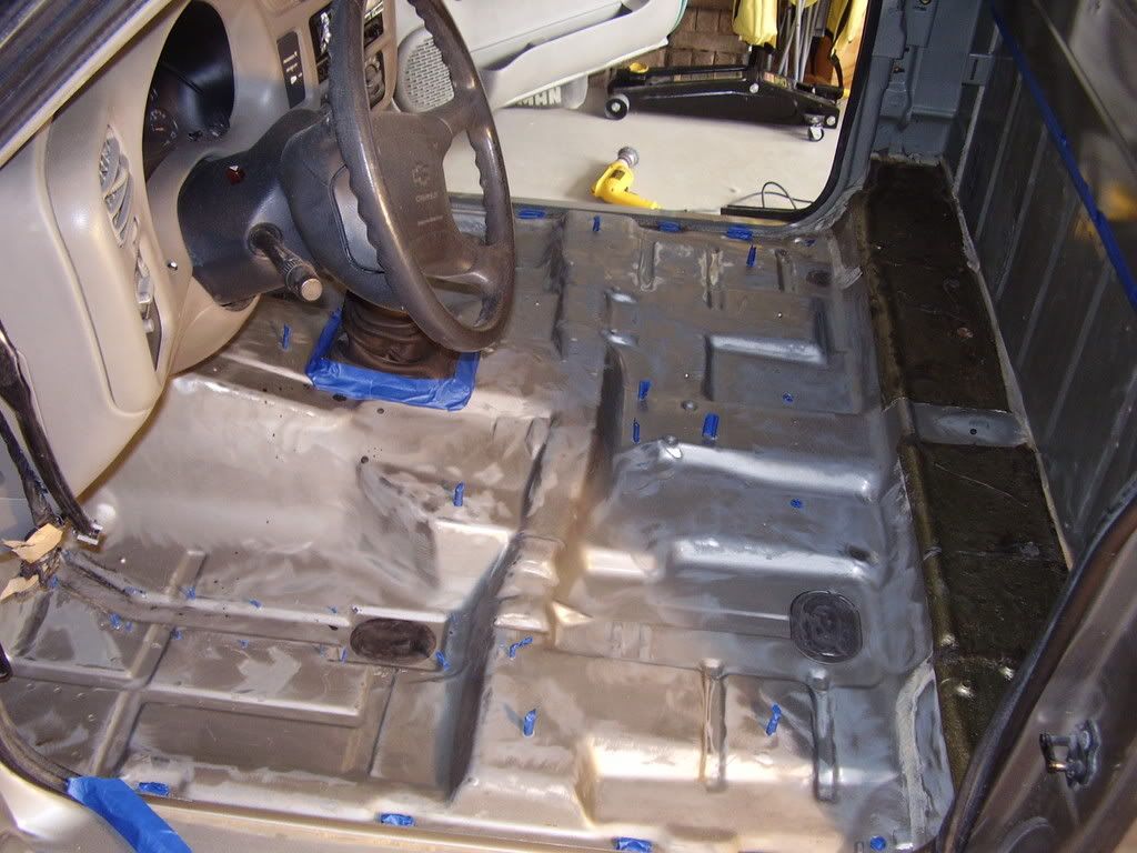

How do yall think I should "scuff everything up" when I do the inside of my TJ? Should I use a grinder with a wire wheel or just some sand paper? I really don't want it to look bad after I do it or have to redo the whole thing because I didn't do it right.
GrizzlyGrip says to just use scotch brite pads on theirs. You need to go over it with acetone after you rough it up. GrizzlyGrip is a little more expensive, but it comes in a bunch of colors and it has rubber "dust" that you add to it to make it more of a non-slip surface. It also has a UV additive that will help keep it from fading.
the inside is metal so it will bond better than it will to the vinyl flares. but even on the inside you cant do too much prep. wire wheel would be plenty (maybe more than enough). like DBS mentioned, go over it with acetone after scuff the surface (make sure the acetone is gone b4 you spray, roll, or whatever) this will clean all foriegn debris
we just herculinered the interior of my buddy's S-10. it turned out great. we used a wire wheel brush attached to a drill to do all the sanding. i don't think a scotch pad or sand paper is going to get the job done. i suppose it could, but it will take a lot longer and will be a lot harder to do. and you want to use xylene to wip down the interior before applying.
as long as the surface is properly prepped, herculiner will adhere to plastic, rubber, metal, fiberglass, wood, concrete, etc.
I used the scotch brite pad when I did the K5 interior and it worked just fine. All you're looking to do is take any shine off it basically. I cleaned mine 2 or 3 times though, I felt thats more important than the scuffing.
