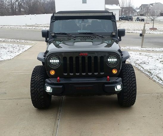

I took the Jeep to Discount Tire and had the new tires mounted on my Anthem Offroad wheels. It really completed the look for me. These are the 35" Nitto Ridge Grapplers on an Anthem Defender Wheel.

I wasn't interested in getting the extension for the 3rd brake light. In the kit, Teraflex includes a mounting option to mount within the tire, but that wouldn't work for me because it involves the lug nuts, which aren't exposed due to the center caps of the wheel. I decided to look for an aftermarket solution and found an LED Brake light that I thought would look good. I think it turned out better than I thought and will really help my jeep to stand out.
