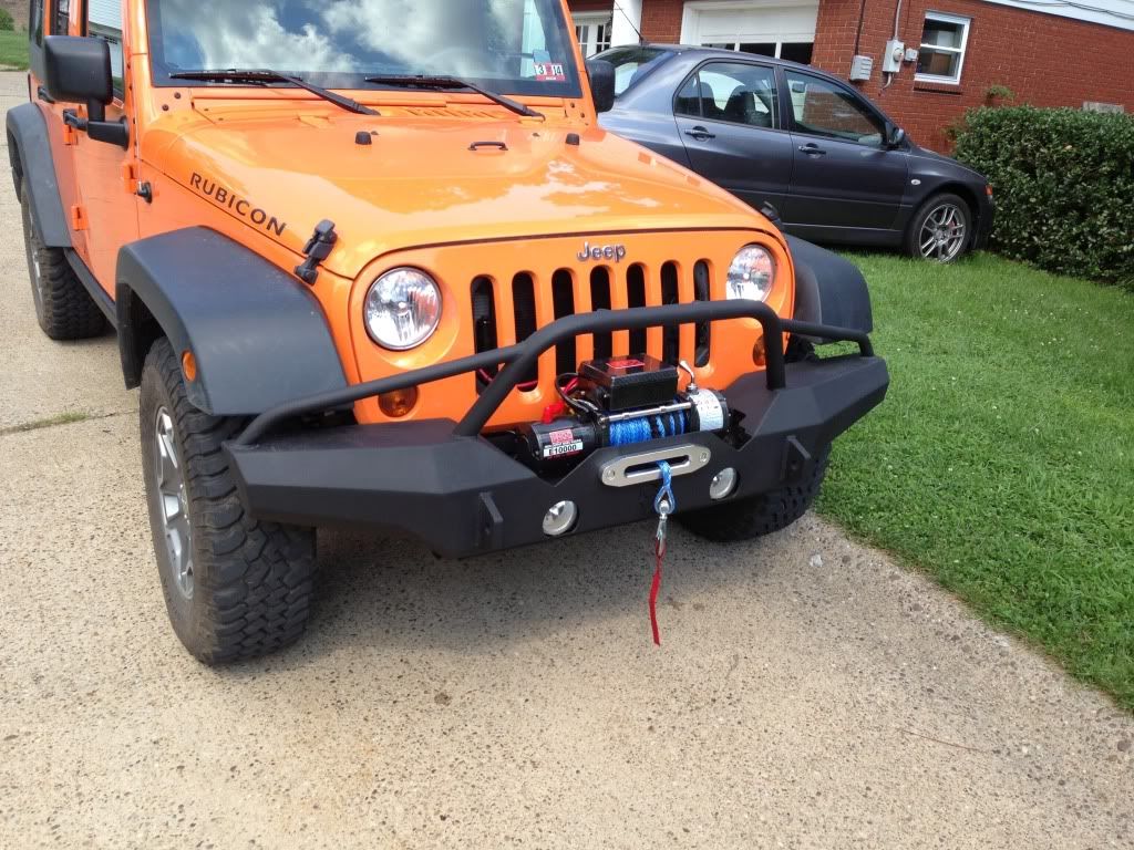

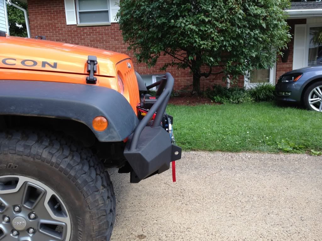

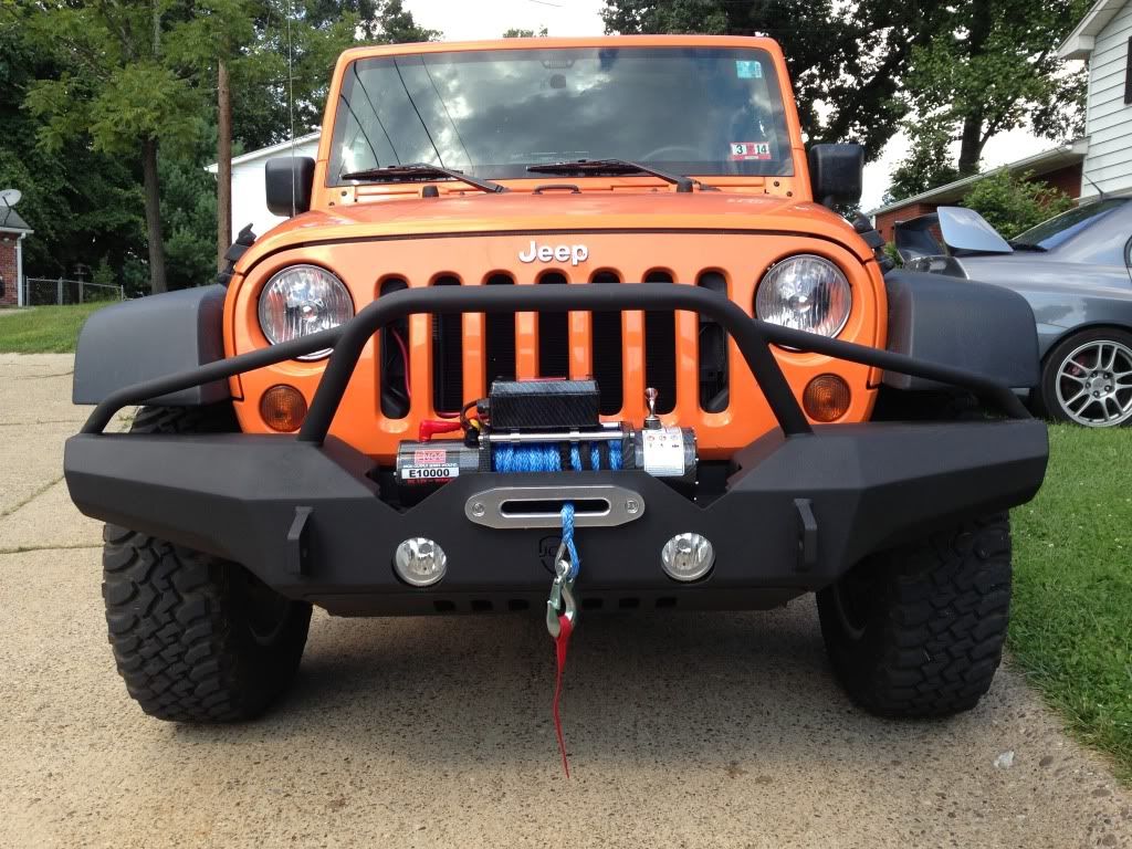

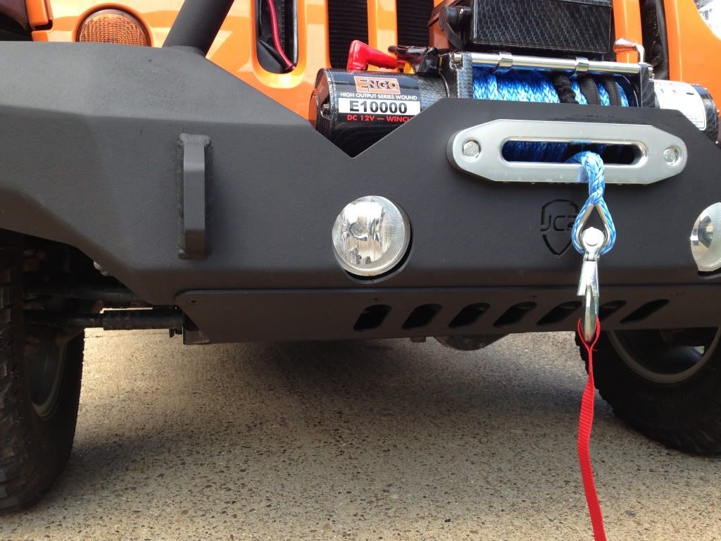

I haven't really seen this anywhere else so I thought I would post it up. I got a JCR full-width prerunner bumper and engo 10k winch. UPS did loose all my hardware but Jason at Krawl Offroad and JCR had another set for me right away. It is a very well crafted bumper and I am very happy with the quality. It looked so good in bare steel that I kind of wanted to leave it that way!
The install was pretty straight forward, JCR's instructions were very good
Did a test fit to make sure it fit
The I painted it with 2 coats of self-etching primer, and 3 coats of spray on bedliner.
Then I mounted the bumper back up
and put the winch on: word of advice! attach both the negative battery cable and ground cable from the solenoid bow to the bottom of the winch before attaching the winch to the bumper. It is very difficult to get to and tighten. Then I attached the skid plate!
I only get 3/8 in drop from this set-up! Happy Jeeping all!:punk:

Yeah the carbon fiber surface is nice but it is starting to chip already, worried it won't last long
599 Posts
The color on the solenoid box also fades to a green eeeeeeekkk. I have the 12k and it works fantastically. But will be mounting the box now, into the the engine compartment. Also the handle on mine as already begun to spot rust while the lower ring of the handle rusted bad so on went the black rustoleum. Otherwise though a great winch and nice looking bumper!
