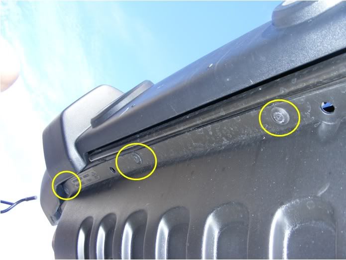

I found a good deal on a brush guard on Craigslist but to install it, the removal of the plastic BS was necessary. Therefore, I decided to take my time and do a step-by-step on the removal of the front bumper so you can see what it looks like in case you want to install a bull bar, brush guard, or new bumper.
First, in order to make it easier to access the backside of the front bumper, I removed the little fascia between the bumper and grill. It is simply held on by 2 plastic screws in grommets. Simply unscrew them and pop out the fascia.
Then it's time to remove the lower plastic air dam under the bumper. It's also held on by the same plastic screw/grommet thing so get all of those out. However, there are also 2 to remove behind the bumper

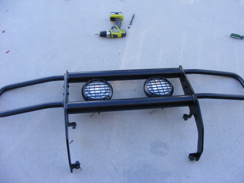

Here is what the bumper looks like removed from the vehicle. You can now separate the THIN bumper from the useless plastic covering. If you plan to use the factory bumper, you can now go back and install it but before you do, attach it and tighten maybe a bolt on each side just to hold it on so you can test fitment of the new accessory you are attaching. I found I could not add my brush guard AND still have my tow hooks on at the same time. It pushed my guard out too far. Because of this, I had to buy 8 new bolts, washers, and nuts since the tow hook bolts are permanently attached to the hooks. Doesn’t matter since I will be changing out my bumper eventually so I can add D-rings and have a thicker bumper. In any case, I also had to drill out 2 holes on top to attach the guard but that’s fine. I also had to fabricate 2 brackets to secure the under portion of the brush guard.
744 Posts
That’s basically all there is to taking off the bumper. Here is what my Jeep looks like with the brush guard attached. I decided to hack up my old bumper up to pieces to cover up the ends and will do the bumper cap mod on the sides. The middle I will leave alone until I get my winch. I will likely have to change that bumper out since the THIN factory bumper won’t be ideal to do any real pulling I figure. Anyone do this and have no issues? It just seems so thin to be able to provide any kind stability.

Does that set up work with the bumper skin on? I notice that you remove the tow hooks. Is there a way to make it work with the hooks? Are you going to leave those other 4 bolts off?
744 Posts
Discussion Starter · #13 ·
well for the guard I put on, the factory tow hooks will not work for me. Doesn't matter as I pointed out since I will be getting D-rings added when I get a thicker front bumper. As for the skin, no it also will not work but I am going to put the stubby ends on since the middle will be a place for a winch. I used some other bolts inplace of the ones that are part of the tow hooks. The bolts on the tow hooks cannot be seperated so I had to buy 8 more with washers and nuts.

So... does the brush guard bar going in front of the headlamps affect the roadway lighting? I know it is somewhat away from the light but still....
No they don't affect it really. But to answer the other response on why this brush guard, it was almost free which is why I took it from the other guy who also had it on his Jeep. Just wanted to do a mod that didn't ruin anything I did. But it really is temporary until I find the one I really want. I'd rather have this one on with some protection than that WORTHLESS plastic crap they include. The new one will have a winch plate and D-rings. Rock slider rails are ordered now.
