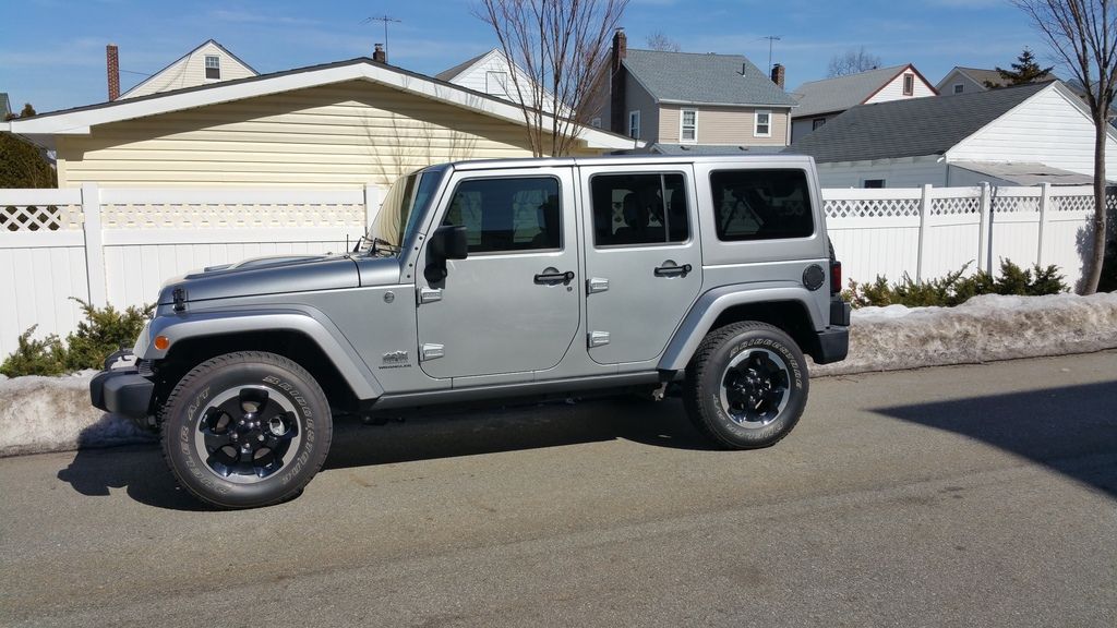

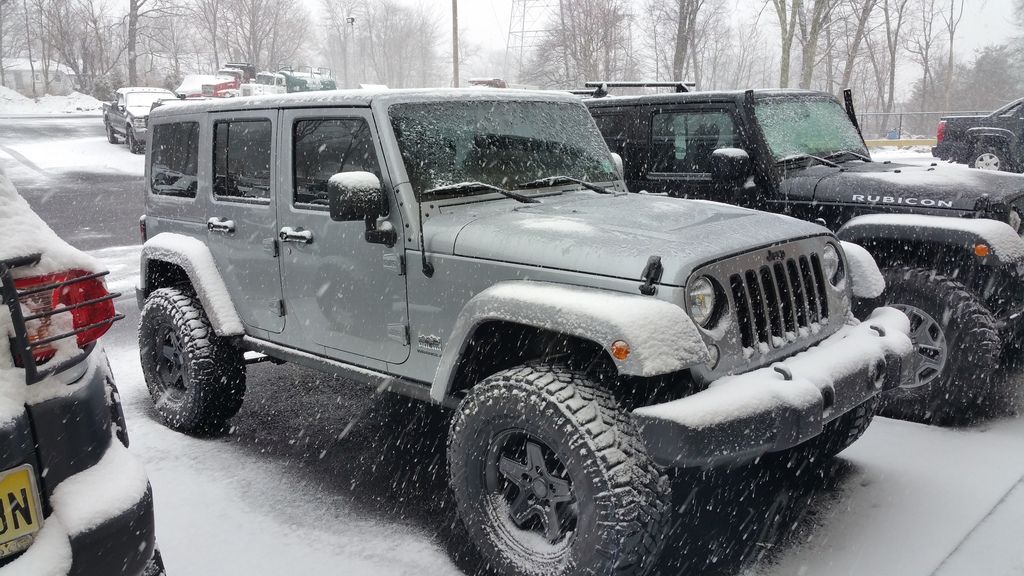

Hi, I recently just had the aev 2.5 lift with pintlers Duratrac 315/70 R17 installed and also a regear to 4.56 ( auto ). Love everything about it. It was my understanding that with these rims you would not need spacers. The shop installed 1.5 spidertrax because they said it was rubbing. I am asking if anyone has successfully ran this setup without the spacers. I think I'm going to pull them off tomorrow and check for myself if there is any clearance issues. Anyway here are some before and after pics.
