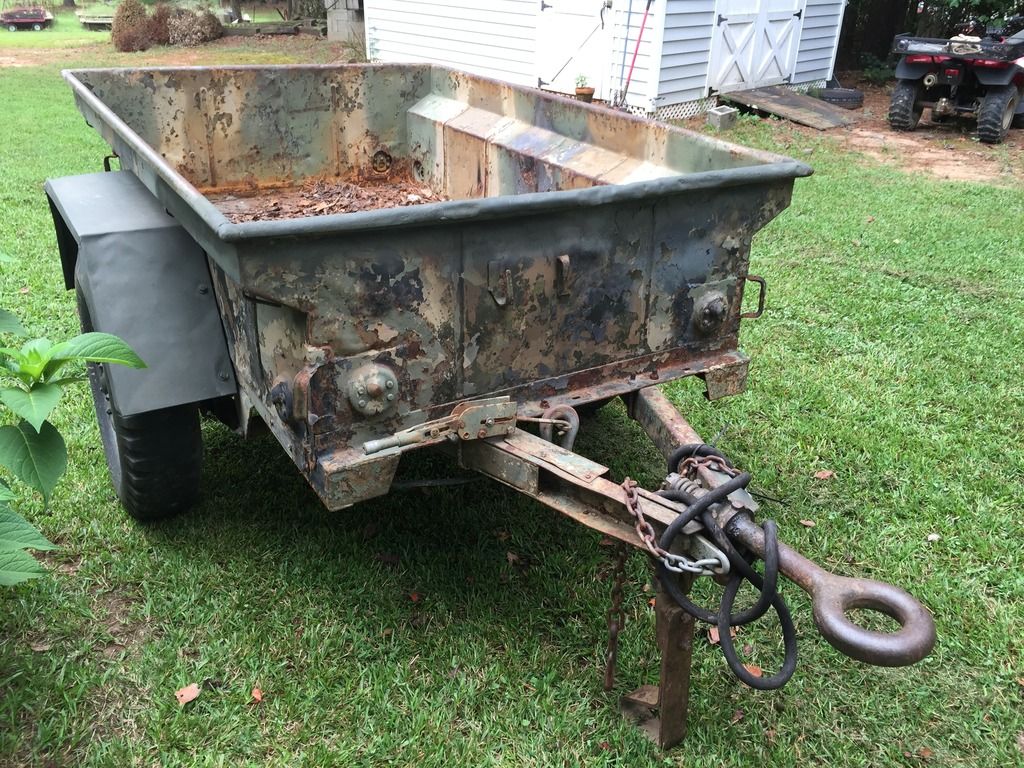

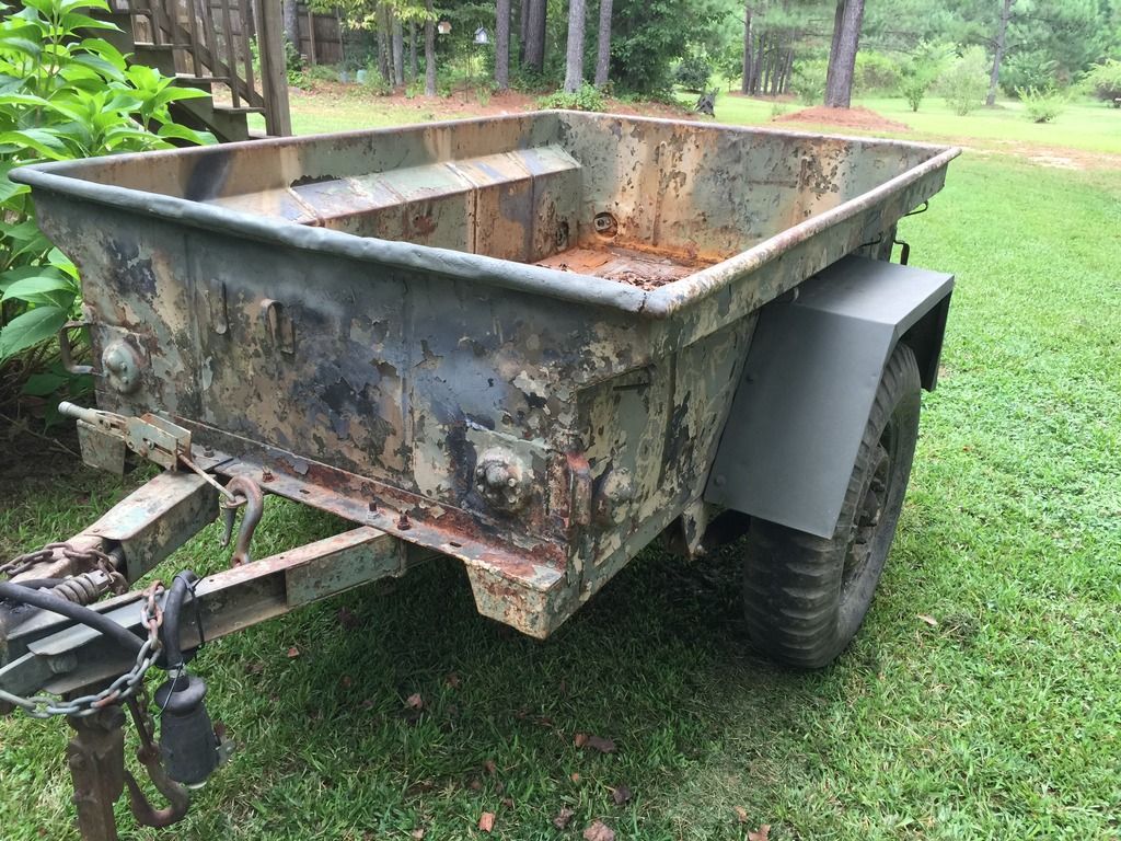

I've been wanting one of these for a LONG time. My dad is a contractor at Ft Polk and has been trying to find one for me, but has been unsuccessful. Well, we finally found some on ebay that were listed locally (to him) in LA and grabbed one back in March. It was a little more than we wanted to spend, but it had all of the original parts. The tub is a little beat up, but I'm not taking it to parades, I'm going to use it!
We finally transported it from LA to GA... in the back of truck!
I have decided to paint it Oregano, which is a spray paint from Home Depot. It matches my Commando closely. Once it warms up again next year, I'll be using raptor liner in the bed. I need to get some new tires one day, but I won't be taking it on the interstate any time soon. Eventually, I'll stuff some modern LEDs inside the original taillight housings, for now, the Harbor Freight lights will work.

Here’s what it looked like the first time I saw it, back in August. My dad did some work on it, mainly repacking the bearings.

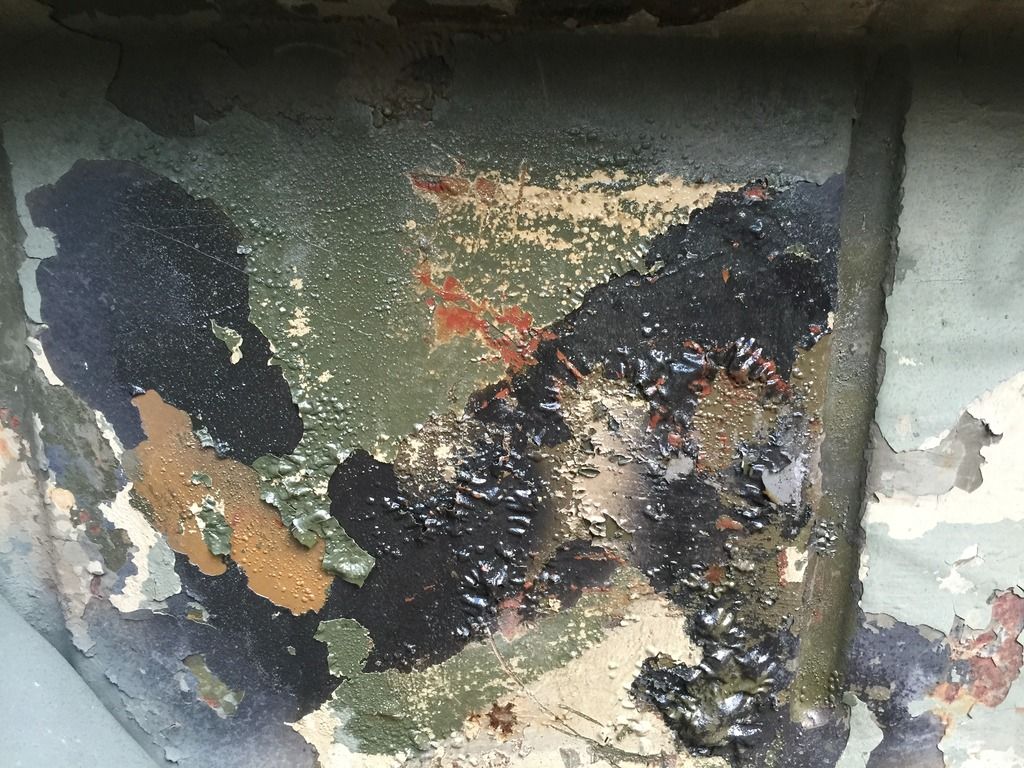

So many layers of paint! That aircraft paint remover works great:

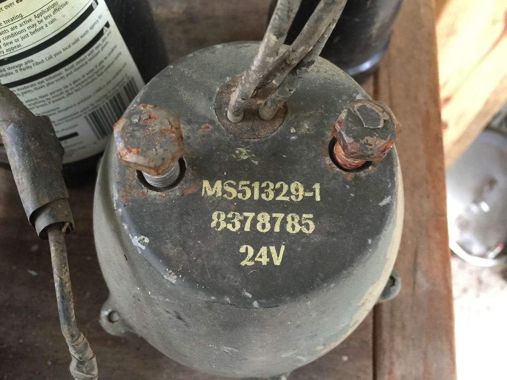

Original lights. I want to put LED’s inside of them at some point.

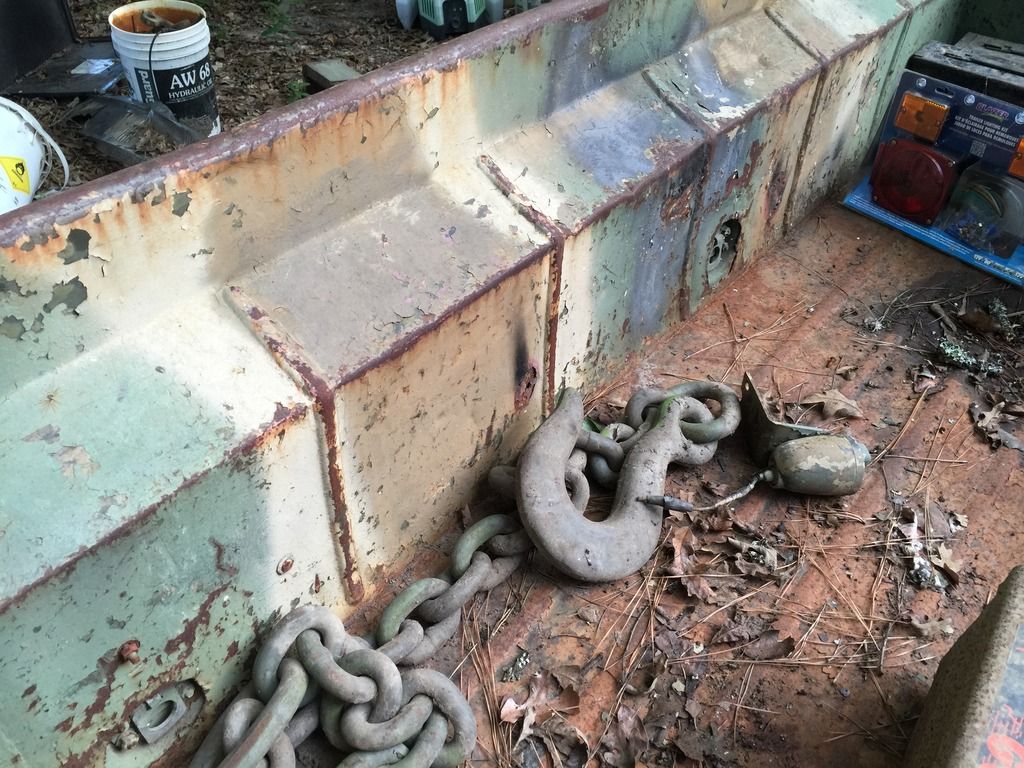

Mine has been modded with tie down points welded throughout. It’s no longer water proof, but I don’t care about floating this thing!

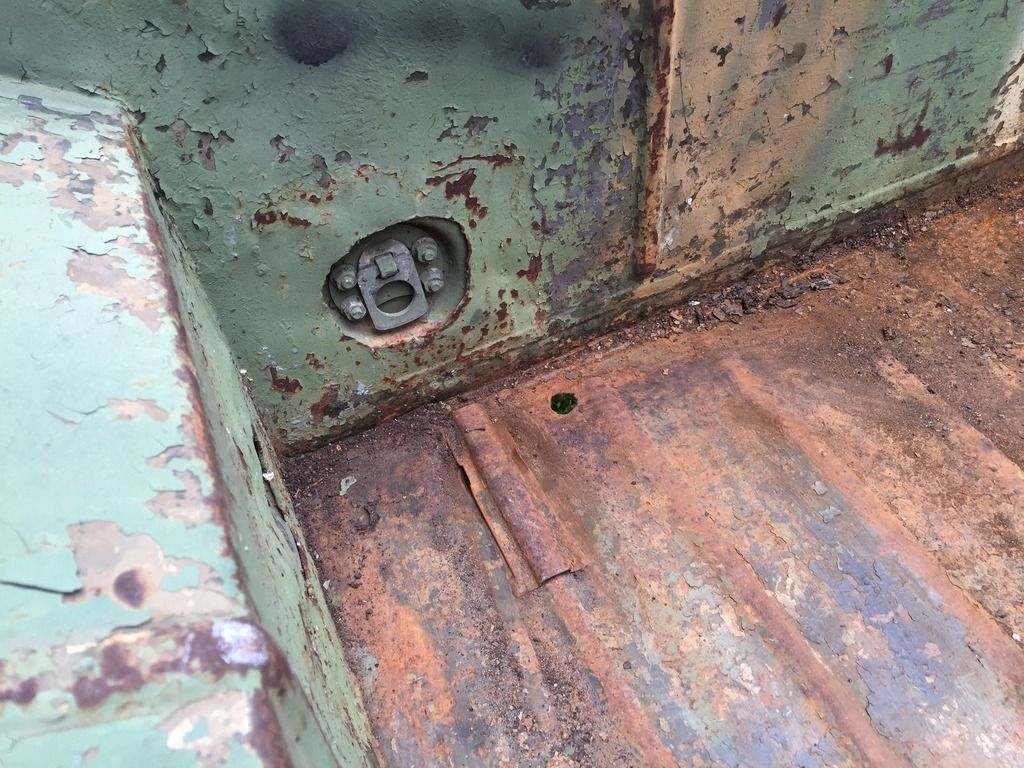

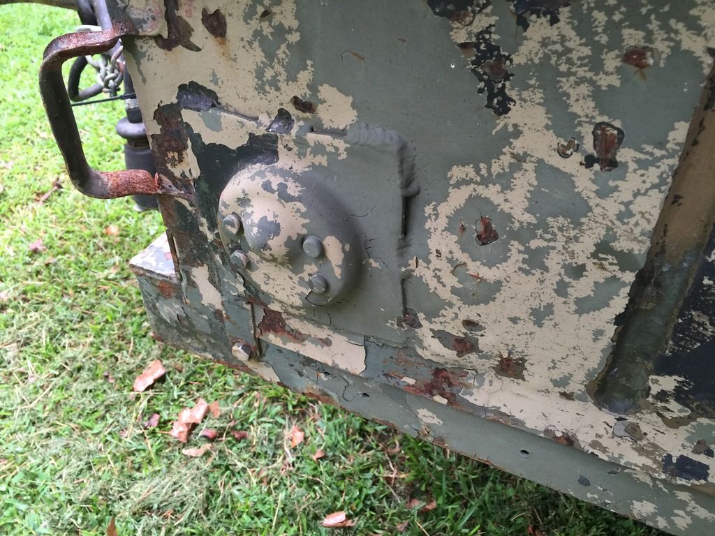

Guess they didn’t see the drain plugs, as someone drilled two holes to let the water drain

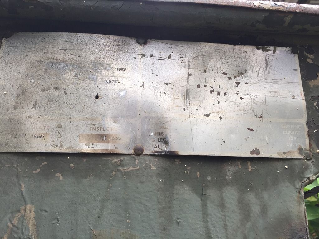

Original data plate. I’ll have to get a new one.

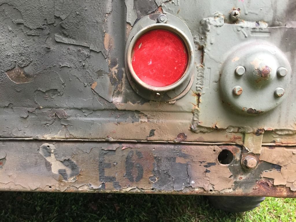

Some original lettering

More lettering

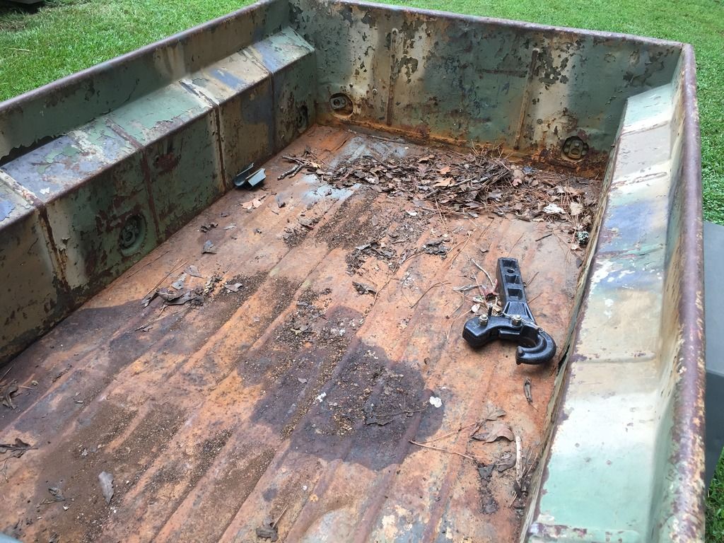

I couldn't help myself and put the wire wheel to the floor of the tub. Most of the rust ended up in my hair. Once cleaned, I put a coat of rust reformer on it. That's probably all I'll do to the bed for now, until spring.
