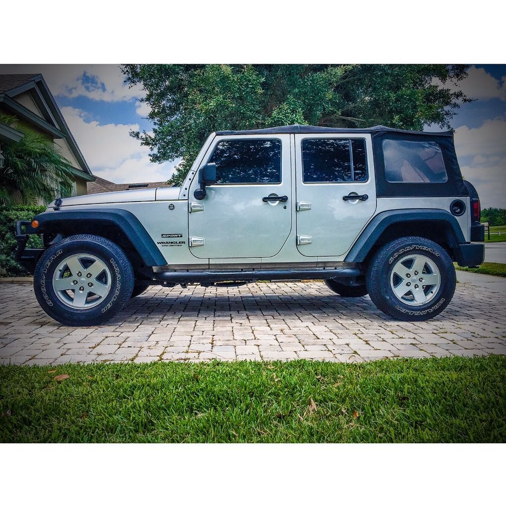

Here she is the first day I got her. The jeep came with a Smittybilt SRC Bumper along with a set of Smittybilt side steps.
