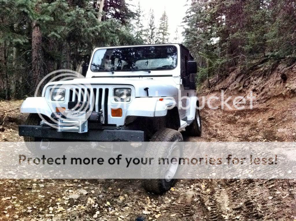

Well, I recently purchased my 95 YJ 4.0 and I am starting my build thread. I have already been wheeling in it and it's my play toy so here goes.
The day I bought it:
First day of wheeling:
Winch installed and swaybar and trac bars removed. Flexes way better:

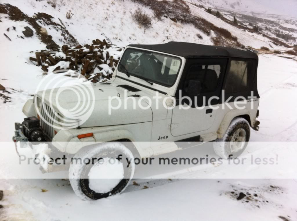

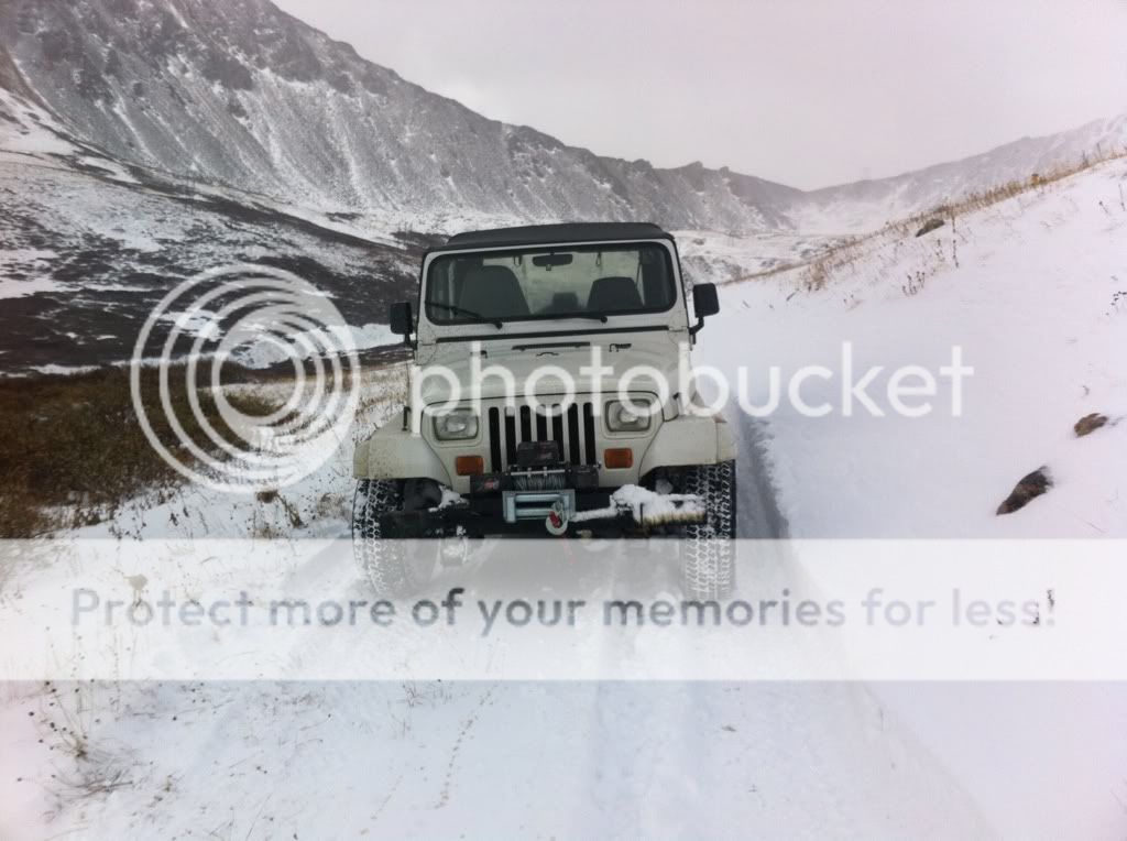

Doesn't do too well in the snow. I ordered the stuff for a SOA and wagoneer front springs and 1.5" lift rear yj springs:
