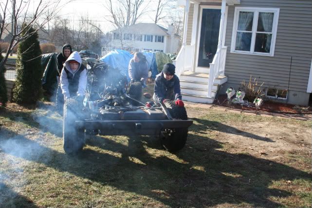

We have had the rolling frame in the tiny garage/"shed" that sits 8' away from our house. The body has been on a cradle behind the shed on a patio. Once the loose ends were finished up, we rolled the frame into the driveway. I gave the girls a rolling jack and told them they would have to "skid" the rear end over to line it up for the roll up the yard (they've done this with me several times during the project). I went down to the basement to get the new body mounts and wanted to see how they would do on their own. They surprised me when I came up. They had their 10 year old sister and 13 year old brother help and they had the frame rolled around the garage and almost lined up with the body. Amazing how they can fight like cats and dogs then put it all aside and work like a team when necessary!
If you look closely, you can see the engine lift behind the body. I tied it to the roll bar and my wife manned the hydraulics. We lifted the front up and slid some 2x4's under the tub and supported with saw horses. I climbed under with my chainsaw and cut the cradle out of the way then we rolled the frame under. We had a couple of old body mount bolts that refused to budge. I used an angle grinder to cut access flaps in the floor and removed the factory "nut". We replaced with large washers and nylock nuts on the new bolts. I will tack the flaps down later and seal with seam.
Sorry no pics of the mounted body. As the afternoon wore on the sun set, the temps dropped 10 degrees, and the threat of snow grew closer so the camera was put away. We rolled the Jeep back to the driveway and it fit in the tiny garage with 1/2" of clearance between the hardtop and the door opening. All is tucked away out of the snow. Now that the holidays are over we'll have to plan our attack. We may just put up a "blue tent" on the front of the garage with portable heaters on warmer days or try to move to a larger garage to work (couple options possibly available from some generous Jeep enthusiasts). Worse case we pick away at it this winter doing what we can and finish in the early spring.
