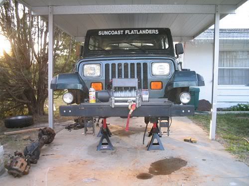

Today I put the jeep on jackstands, removed the tires and removed the rearend, It took me about 1.5 hours to do this bymysefl with hand tools
I will be working on the jeep in the afternoons after work and hope to have it finished in a couple weeks, I have helped with a SOA and Slip Yoke eliminator before so I am familiar with the process. I will post pics and lessons learned as the build progresses.

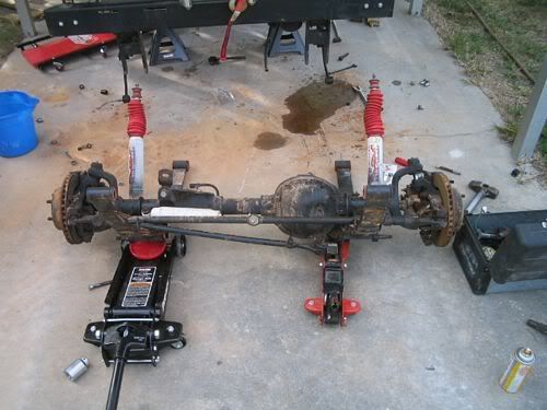

well I spent about 3 more hours on my jeep today got the front axle out, all shocks, sprigs, track mars and sway bar off I am kinda at a stand still not till I get parts in the next thing i am going to do is install the slip yoke eliminator kit.
This is the damage from croom third break for the D30
Track bar begone!
I basically bench pressed the D35 out from under the jeep but the D30 with the steering was going to be way to heave so I used 2 floor jacks to support the axle and unhooked the drag link, shocks, brake lines and springs then lowered the axle down and drug it out and dissembled it.
