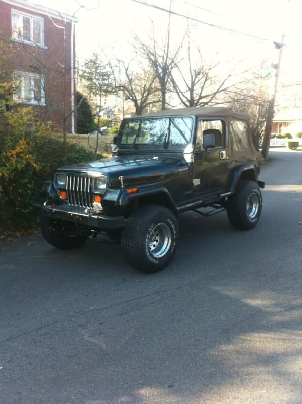

Hey guys I have picked up 1988 wrangler as some of you know and its been sitting for about 3 years and now it has a lift kit and some 33inch tires and now when im driving about 20 to 30 miles and I hit a bad pothole or something rough in the road my jeep starts wobbling like crazy like it feels like the tires are about to fall of. A friend told me its the steering dampener? is this correct? I don't want to buy parts that wont solve this issue. The tires are all in good shape and I checked all the bushings up front and everything seems to be good and there's not much steering play. I also want to get a wheel alignment but I want to change any suspension parts I might need before I do the alignment. Here is a pic to get more of you interested as I know we all love seeing pictures of wrangler :D
