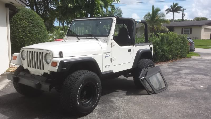

Hey Guys, I'm new to Jeep and to this forum. I just purchased this 1998 about 5 days ago and I have been doing little cosmetic things here and there. The previous owner didnt really take care of it.

Is there supposed to be anything where those holes under the grill are?? (on top of jeep sign on the fender)

it appears as though you have a rather large body lift, that is why your grill has those large gaps under it
this is prbly another reason y the shift boot was removed/disconnected when you purchased the jeep

I agree with brs256. It looks to be a 2-3 inch body lift. I'd try to get that replaced or shaved down to a 1" BL and a suspension lift to clear the tires if you can swing it.

Bad news for me.
I just went back to my sellers craigslist post:
". Has 3 inch body lift with 33 x 12.5 R15 BF Goodrich tires. Borla headers, FlowMaster exhaust. Dana 4:11 differential gears. "
Can you guys guide me the right way. I have read nothing bad bad news on anything over a 1 body lift.
What shocks and springs should I get?
What 1" BL should I get with?
Is this something I can do at home?!
I would like to keep the same wheel tire setup (all I have)
265 Posts

Definitely not bad news. You don't have the problem 90% of this forum has. Weak axles and stock gear ratios dragging us down.
The body lift is simply done to clear tires. It does nothing for offroad/driveability etc.. except minor details when doing a tummy tuck. You have plenty of options. If you trust your fab skills, you can remove the pucks and cut them, but it might get complicated and there's a chance for error. The JKS 1.25 BL is a great kit that I have on my jeep and highly recommend. Inspect your body mounts though, if they look like they've seen much better days, the Daystar 1" kit will replace them and provide the 1" BL that is much more practical. A Body lift is something that can be easily done in your driveway with a jack and simple hand tools. You will have to inspect your fan shroud to see if it needs modification after the body drops a couple inches. Your fuel filler hose may need adjusting as well as your transfer case linkage.
As for tire clearance, I'm not well-versed in the "what lift do i need for what tires" etc.. but I can tell you 1" BL is not enough for those 33 tires, and you will need some sort of suspension or budget boost lift in order to clear them.
My final advice? If you can't swing a 2-3" suspension lift at the moment, run with what you got. You're not gonna die because of it like some members on the forums believe, but it's not the best setup. Save up some cash and put it on the list.
Enjoy the jeep! :thumb:
Edit: If you do decide to modify the body lift yourself, the hardware may be too long and the radiator supports would also be too long, so it may be a little more work than it's worth.

Thank you for the great advice. I'll run my current setup for now till I come up with some money for suspension.
Next question.
Will I be better off doing a 1" body lift with 2" suspension or should I go only with 3" suspension???
Yo also mentioned possibly moving the fan and filler hose. I've never really done any engine work lol I might he to have someone do the install

I would look into the zone 4.25" combo lift. I've heard a lot of good things about it

There's tons of options. Most guys prefer the BL SL combo to keep their driveline close to to stock while still getting that 3.5"+ lift. A 2-2.5 lift will do just fine. If you jack it up too high you start getting into driveline geometry etc.. A 2.5 lift is nice because you won't have to drop the transfer case, you can simply install a motor mount lift to keep your rear driveline close to stock angles.
Don't let the fan shroud scare you. It's simply four bolts and the previous owner probably put slots in the shroud to allow it to be moved down on the body so it wouldn't interfere with the engine's fan. Simply loosening those bolts and adjusting the shroud so it doesn't collide will do the trick. The filler hose is a couple hose clamps that loosen with a screwdriver and can be adjusted.
On my rig, I have a 1.25" BL, 2.5" suspension lift, and a 1" Motor mount lift and I'm perfectly happy. Relatively inexpensive as well. But that's just my preference.
