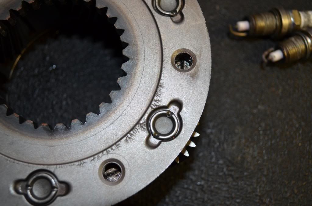

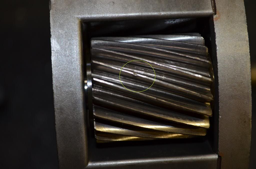

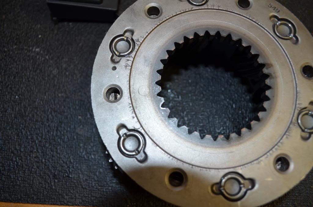

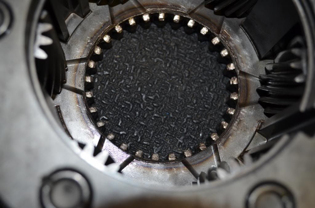

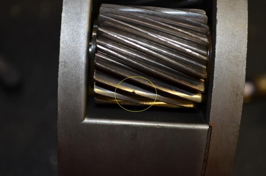

Planned on upgrading my np231 TC when I did my SYE so I got this used 241 planetary and the pictures weren't good enough to show this wear. Is this normal, will I be good to go. It looks like the middle section has been subject to some wear there is a small ridge in the center on the gears side. Whatcha think, Use it or into the trash heap. The one nick is the only problem I see with the gears, thanks in advance.
Edit. Also are the spider type lines on the back stress cracks, casting defects or what?

It looks like that gear has been exposed to some serious heat. That along with the chips in the the gear teeth and the spider cracks would rule it out for me.
