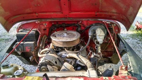

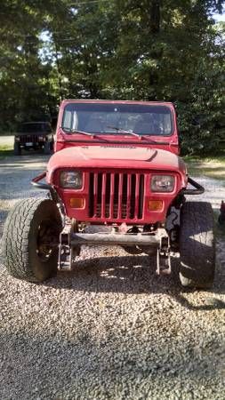

I picked up this jeep today for 3k delivered to my door. It is time to let the fun begin! As it sits right now it has stock 350, turbo 350 tranny, with a NP208 GM tcase. It has a two inch body lift and a 2 inch shackle lift (they are huge) with 33 inch bald tires on 16in aluminum rims. It came with the top that's pictured and the full soft top. The interior has best top seat and the dash is diamond plate and new gauges. Rock sliders, crusher corners (unknown damage beneath) and flat fenders. As of right now the transmission will not go into 3rd so its already sitting. Hopefully I will get some time Saturday to mess with transmission if not I already have my eyes on a rebuild transmission. O yeah the windshield is destroyed. Im suppose to go overseas at the end of the year so the goal is to get it running smoothly before Nov. Then spend big bucks when I return.

Started tearing into the drive train to get this figured out. Transmission had water in it so its off to the shop for a rebuild. Should have it back in a few days. I could see that 3 freeze plugs are leaking so they are all being replaced tomorrow. I guess when the drive train was pulled from the donor vehicle they cut the hard lines for the transmission cooler. I have the lines just need to make new gas lines and cooler lines. Motor runs great with unknown miles. Discovered that the tcase is a np241C. Here are some current pics.
