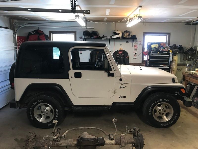

So the time has come to start my project. Back in October 2016 I bought my first TJ. It is a 1999 sport 4.0 auto with 293,000 miles for $2500. My goal is to be at 3.5-4" of lift on 35s with a manual conversion done right. It has a fair bit of rust on the frame and a bit on the tub so I've decided to do a complete frame off resto. My plan is to mock up everything that requires cutting or modifying the tub and fix all the rust so that a can blow it all apart to sand blast the frame and tub before I spray the POR15 and underbody. Here is my projected build list along with some pictures of the first few hours of work.
Build list:
Metalcloak 3.5" lift
35" tires
Ford 8.8 (4.88s)
HPD 30 (4.88s)
Reman NV3550
Reman NP231
SYE
Barricade bumpers, winch, fenders, and rocker guards
full exhaust system
Intake upgrades
I'm sure I'm forgetting some things

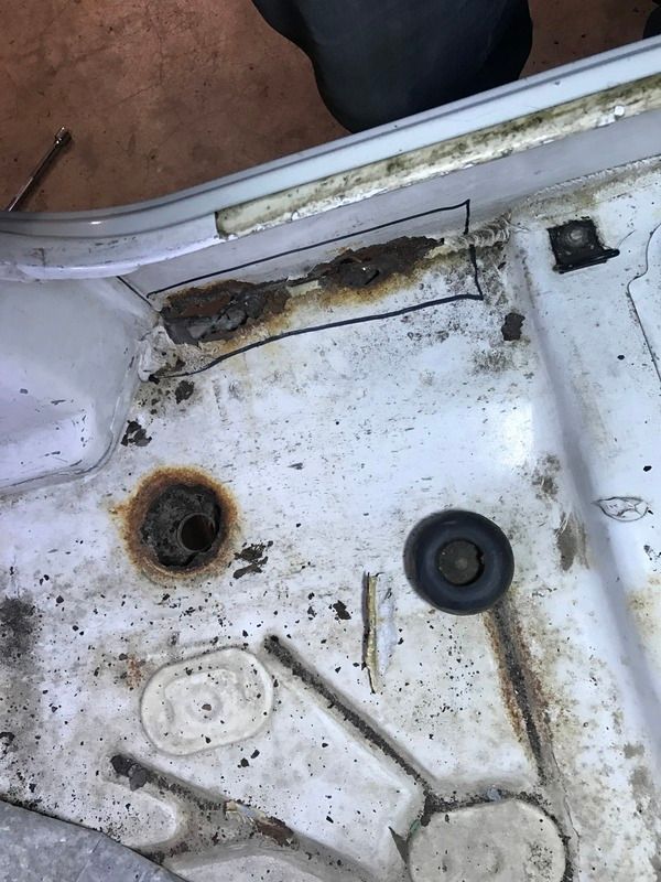

A little more progress, I planned on welding in patch panels where the rust was on the rocker panels but all I had was my TIG so I'll have to wait until next weekend to bring home the MIG and do all of my welding.
Decided to start on the interior until I can grab my welder
Replacing that whole floor pan
