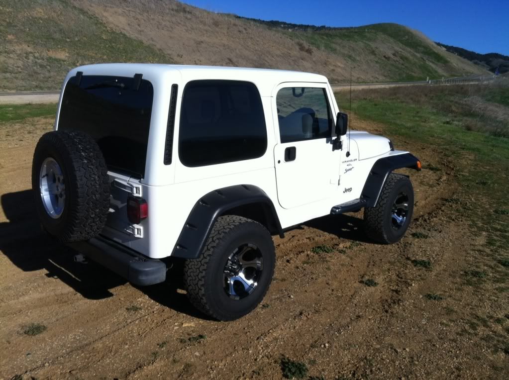

Anyone know what kind of paint to use to paint my hard top. I have a HVLP gun and an indoor area to shoot it. Just not that up on paint. I really never have been. Just the mechanics. Type and brand would be great. I want it satin black. No gloss, but not a flat either.
The top is white right now. But it dose not match the body. I guess fade over 14 years will do that.
