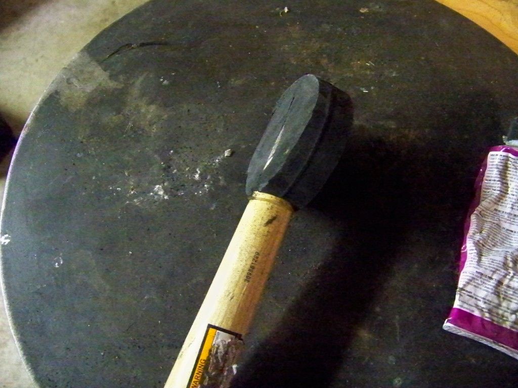

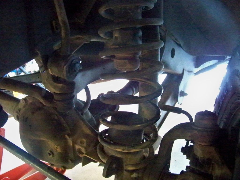

So I have no idea if this has been tried before, but I figured I had to try it once I had the idea.
Bought a cheap 2 lbs Rubber Mallet. I think it was $3-4.
Hacked it up with a sawsall.....
ShoeGoo'ed the Rubber to the to lower spring plate...
It meets up with the upper bumpstop before my 33"s contact my fender flares (about 3/4" fender flare clearance.)

you do realize the jounce bumper will fully compress into the cup, right? and you understand that the grainy picture you showed above, of the jounce bumper just touching your rubber mallet, is basically irrelevent, right?

Yeah, that pic was for gluing alignment. ;)

So far so good with 2 days of testing. Suspension flexs\cycles while disco'ed with no fender rubbing as I had hoped. It will be interesting to see how long the shoogoo holds.

Understood...So what I think I am testing the most now is how well/long the mallet rubber bonds with the shoegoo and metal.

Yeah, I can fabricate..I have a mig welder and some general metal working stuff so I can easily make my own extensions, but this was one of those, "I wonder if it will work" things that I wanted to try... and if it does then maybe other can utilize it too.
