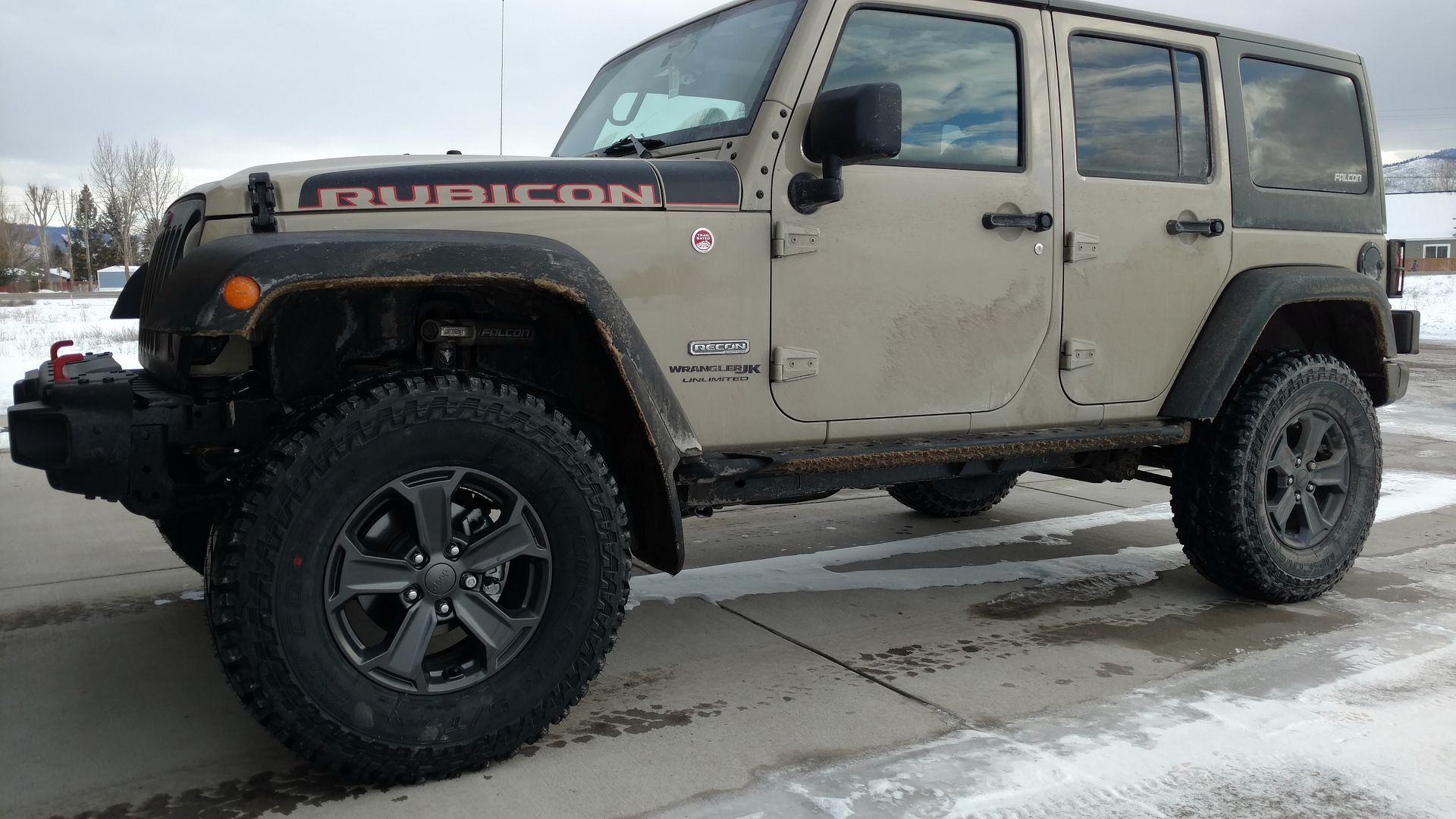

this is what it looks like with 285/75-17 and 2" spacer lift.
Thanks for the pic. Needed to see how that size tire looks. Your ride looks Great! Freaky thing is that it looks like your Rubicon is in MY driveway!
How do you like the Cooper tires? Did you put the larger tires on before the lift?
I'm seeing now that modifying my Jeep will be addicting but fun!! So far, I have only modified the sound system, put in a remote start for a manual tranny, and a rear back-up camera. Out of curiosity, how much does a lift like yours cost?
If you were to go back over the years and read my posts you would find that I am somewhat of a tire whore. I would wager nobody changes tires as much as I do. I like these Coopers a lot and in fact my last 3 sets of tires (in a years time) have been Cooper st/maxx's. you really do need a small lift to run these tires. the AEV 2" lift is $285.
I vote two inch spacer lift and wheel spacers
I did a 1" Teraflex spacer front and rear, and running Cooper STT Max 295/70/17 on AEV Borah wheels.
