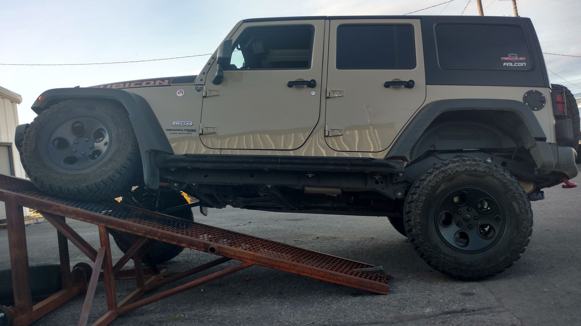

I've attached a couple pics from the trip this past weekend. Front was pretty much maxed out on the bumpstop and close to pulling the drivers rear off the ground.

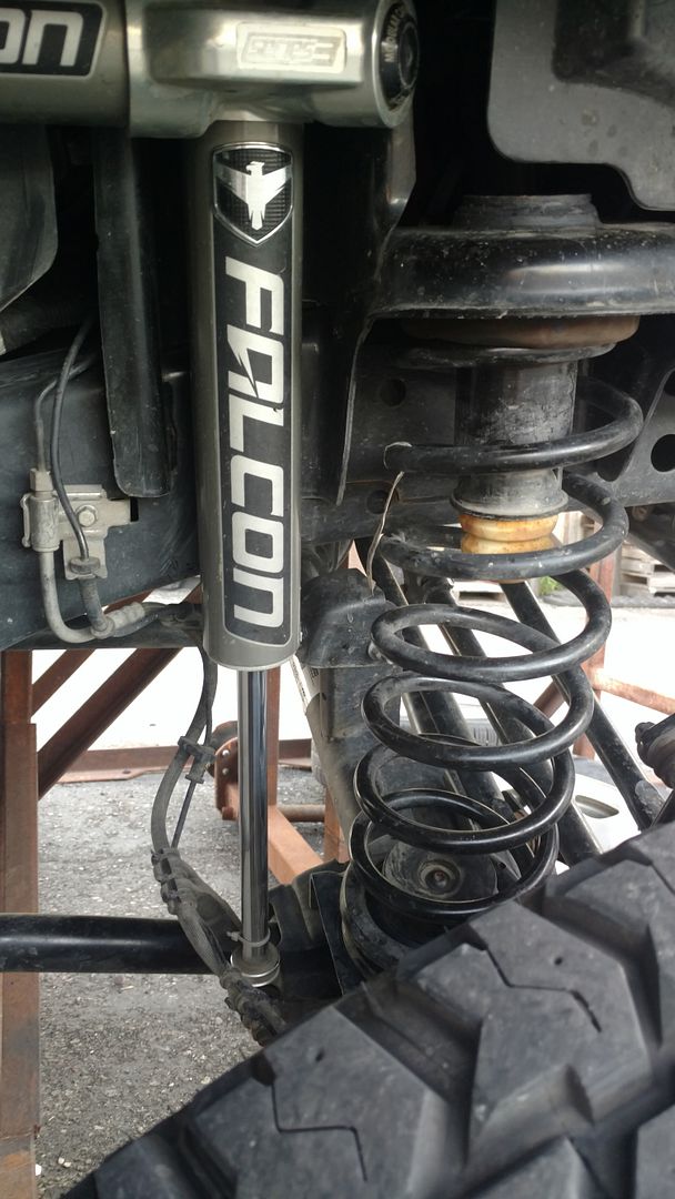

your set up is very close to mine. I run 1" bumps front and rear and for me that is perfect fully flexed out. I run Falcon 3.1 shocks the 1.5-2.5 size but in back could probably go the next size up. it is a flip of a coin. I get pretty much max flex with this set up. this is with 285/75-17's Running hard trails in Moab I still am not quite bottomed out on the shocks so for me 1" bumps are perfect and maximize my articulation. I was there in June and just got back a few days ago again.

Go up to the next longer version, they are 27.25 extended. I run the Falcon 3.1's that are over 28" extended with a 3/4 coil spacer and it's fine. That would be the same as the Fox without the coil spacer.

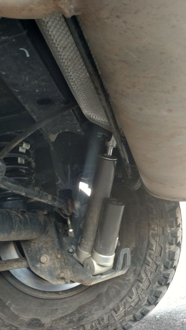

Yes, it's the long version. The fronts are roughly 3/4 shorter than the Falcon 3.1's I run with the Mopar springs using a 3/4" spacer... Those should work in the front.
There is higher risk in the rear... The Falcon's are 27.7 and the Rocksports are 27.8, virtually the same. But I am running a 3/4 spacer there as well. I don't think the Mopar springs will handle the 27.8.
The way to tell is to disconnect your current shocks and lift the rear by the frame and let the rear axle droop until the springs just come slightly loose. Measure from the lower shock mount hole up to the mounting pad. Then subtract 1" and that is the longest shock you can run. The 1 inch is the typical distance from the top of the shock used for measuring up to the center of the top hole... In our case it's occupied by a bar mount.
