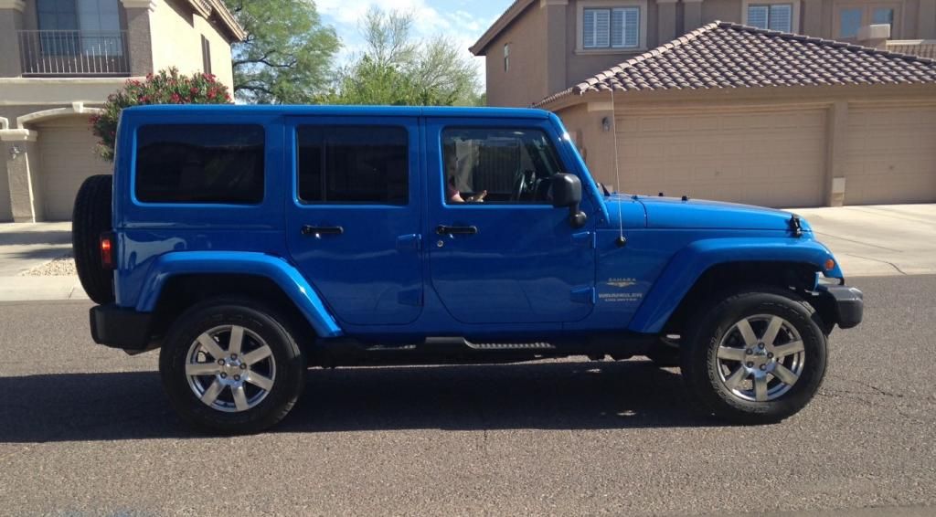

If you just want leveling, you can do just a 1" puck on the front. It's $32 and a couple hours and you should be nice and level. Mine is a 4dr., but this is what it was like with just the 1" puck up front.
