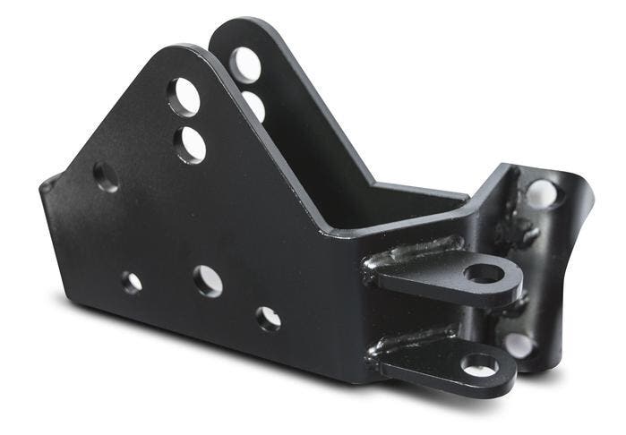

Are those brackets on the left for a Steering Stabilizer mount?
Does look nice and beefy for construction!
Not really liking the position of that if in fact it is for a SS. When the SS gets mounted too far right, the Tie rod mounting point does in fact get in the way of the differential covers in many cases.

It is an SS mount bracket on the drivers side. You might also notice there is a hole to mount the SS in the more traditional location to the passenger side of the 2 trackbar holes. So you can pick where to mount it depending on where you need clearance the most, like inboard if your XD draglink & attenuator need clearance, or outboard if you have issues with clearance on the tierod mount as you mentioned.
It also comes with a drivers side swaybar bracket and the option to use that or mount longer links in the stock swaybar mounting locations.

It looks like a good piece to me. I'm ok with the SS mount, might just need a different mount on the tie rod to move the SS away from the diff.
It looks like a good piece to me. I'm ok with the SS mount, might just need a different mount on the toe rod to move the SS away from the diff.
Agree P! It's nice to have the option to use the bracket or standard SS mounting location. I also like the option of using swaybar link brackets or stock link mounts with longer links. Nice to be able to fit it to the specifics of your rig!
I also like that it's one piece welded 3/16 steel. We'll see if that causes any issues with fitment on the axle mount or getting the trackbar in there! I'm sure the tolerances are pretty good since it's SteerSmarts

JeepR KReapR.... It's 1/4 inch steel. Very strong and we built it strong to handle our XD trackbar when released next month. The optional stabilizer mount works great with the YETI Tie Rod linkage.

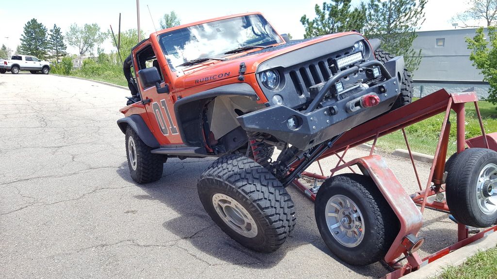

I run the Yeti XD Tie rod and drag link Griffin XD and the FOX ATS 2.0. I was able to finally stuff it on a ramp both sides and I am happy to report no contact to the Griffin boot or ATS.
Looks great RC!!!
