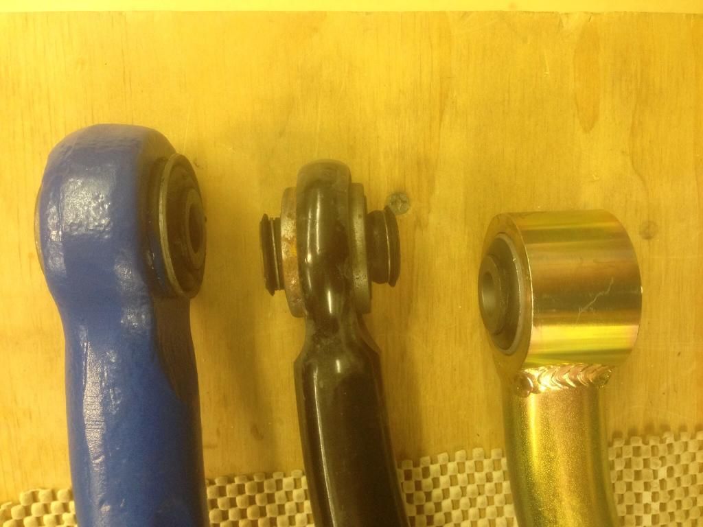

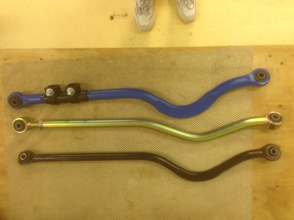

Just for comparison, here is a picture of the TeraFlex (blue), stock (black) and JKS (gold) side by side. You can see the difference between them for yourself. Holding them each, there is an AMAZING amount of difference between the TF and the JKS. The TF Monster Trackbar is significantly heavier than the JKS.
We love the TF. Our friend who bought the JKS told us the day we installed them on our jeeps said if he'd known how much more stout the TF was, he would have bought it instead.
Just thought this might help you decide. Good luck with your mods this week! :thumb:

Picture? What picture? ;)
DAMMIT!!! :facepalm:
That's what happened when you try to post coherently after working on jeeps all day! :nonono:
Sorry about that, OP! I fixed it and now there's even TWO pictures, instead of just ONE! :D

Well TWO is better than one! I REALLY DIG the blue paint... excellent!
For what it's worth, the TF monster Trackbar comes in black. I just painted mine blue with some of the blue caliper paint I had left over.
I agree though. I like throwing random blue stuff under there! :)
