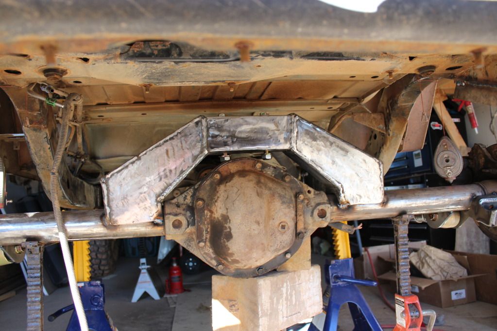

Then home fabbed the rear axle bridge.

I know why its a suspension "package" and not a kit....It comes with the raw materials to do the job and pictures of what it should look like when it is done. If you can't figure out your geometry and do ALOT of fab work its not the one for you. You get joints and shocks and most of the brackets and tabs. The rest is cut weld and do the math.

Welcome to the fun stuff. ;) Erase "bolt on" and "kit" from your vocabulary.
What are you guys doing about steering?
What size tires will this thing be running?
Gonna build a crossmember for the trans mount or drill some holes in the new plate?
Have fun fitting CO's on TJ axles without going through the tub. :thumb:

All the "smart stuff" is up to them!! They have already built the new crossmember.
He is going to run 37's on it; and as for steering-- more smart stuff!!

Well as u can see from the pics we got it done. Tera flex nuckle and Dom with heim joints for drag n tie rod. Nothing protruding through the body. It all fits with a lot of figuring n fabing. Will try to get some pics soon of all the stuff welded on this beast. It has great road manners and runs strait. Flex like crazy and good manners. Not a bad combo. Pics n descriptions to come on what we had to address to get it done on stock axles.
