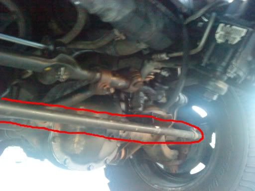

My girlfriend recently got a 04 TJ. Today she got on the free way and as she accelerated she the car began to shake/wobble. She quickly exited and as she slowed down the wobbling subsided.
Now when I drove the car, I notice as I approach 50mph I can feel the front end begin to shake and the steering wheel wobble. As I slowed down the it ceased, but I really couldn't take the car more than 45mph.
I just read an article about the "death wobble" and I want to share the car's history since it seems to pertain to what I read.
Previously the TJ was in accident. In the process of getting the car put together and running it was discovered the wheels were grossly out of aligned...Well not that bad, but it was definitely visible. At the time it was suspected it was the track bar because there was difficulty getting it back on(If i recall it seemed that the track bar was making the front passenger tire stick out).
It was taken to a shop and learned that there was frame damage. Well supposably that was taken care of and the car was then taken to be aligned. While finishing up the alignment we were told the bar (pictured) was bent. Is this the trackbar? I thought the real trackbar was another part located just beyond the one pictured? What are the chances of this being the source of the wobble? The car is not lifted. Its an 04 so I don't think any of the rubber parts or the ball joints would be too worn. If it is a track bar, is it recommended to get an adjustable one because the car might be a lil tweaked?
Thanks in advance.

The item pictured is the tie-rod...loose/bent components in the front end could certainly cause death wobble though.
9 Posts
I'm a fool. After I posted this thread I found a great picture showing me the names and locations of certain parts.
I know the part circled in red is the tie rod. The tie rod was told said the be bent when we got the jeep aligned. Would this effect wobble?
The part I suspected to be the track bar is the track bar. I know this would effect wobble. Is it a good idea just to get this replaced. Should we go with a stock track bar or a adjustable one?
Also, when the jeep was taken to get the frame fixed, the lower control arms were replaced. Would this be a factor too?

As stated, any bent or out of line steering components will cause a steering wobble. If it were me, I would have the frame checked for straightness on a laser frame straightener. You really need to start with a straight frame and work your way back from there through the steering components. If its just the tie rod, you can get one from a salvage yard from a ZJ jeep that is bigger and stronger and should be cheap.
The place that took care of the lower control arms, but not the alignment, was where the frame was inspected and straighten back to normal as much as possible. I dunno if a laser straightener was used or not.
Now the one who took care of the alignment was the one who spoke about the bent tie-rod. But he didn't have any knowledge of was done to the car before hand.

It definately seems to be steering components. If you are comfortable witht the way the frame was fixed, go ahead and try a new tie rod, check the torque on the track bar at both ends, make sure the ball joints are ok and see how it goes.

Improper alignment will never (!) cause a shimmy but an out of balance or bad tire or bent wheel always will.

Ummm I'm pretty sure any part dealing with the steering or other components such as a tie rod being bent could cause it though!!
While a bent tie rod will increase the amount of toe in and cause accelerated tire wear, it won't cause a shimmy.

The thing about a bad alignment is it will only cause steering issues or unusual tire wear. The steering issues being poor or lack of steering wheel return to center after completing a turn, pulling to one side, or poor tracking where constant steering input is required. Problems with unusual tire wear from a bad alignment including feathering, more or uneven wear on the inside or outside edge, or cupping.
But when there's a shimmy or vibration felt through the steering wheel, that's always going to be tire related providing the wheels are not bent or dented. With the wheels are ok, shimmy or vibration is always going to be caused by the tire itself. Out of round, a bad spot on the tire, lost wheel weight, manufacturing defect, or more likely they are simply out of balance.
