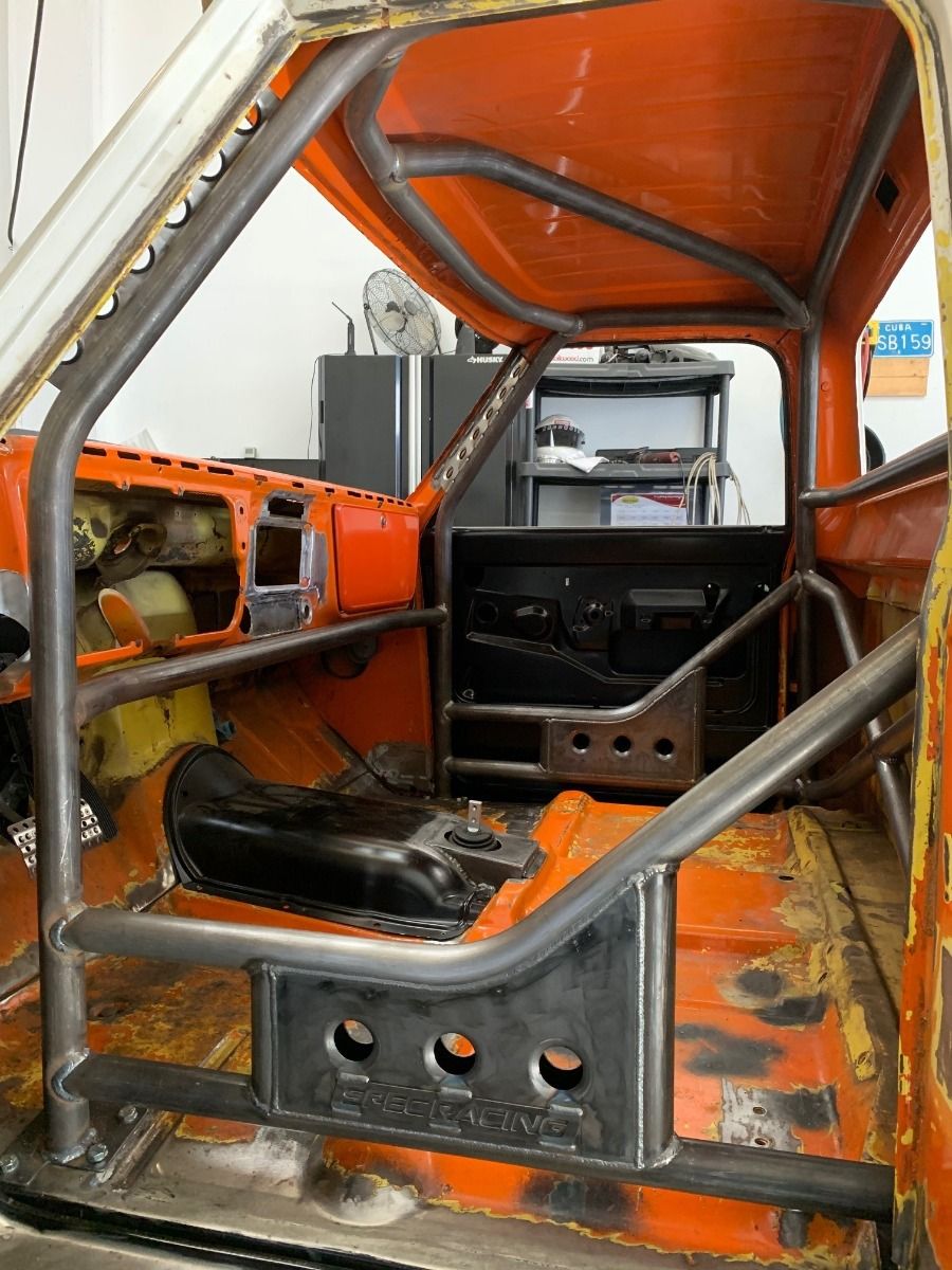

couple questions on this plan.
using hard half top on TJ that is a classic CJ8 top so I would NOT want to drill hole in it for rear half family cage to go thru it. Cant afford a GR8 Top. Besides... the long rear deck idea does not work as well with rear half of roll bar anyway.
well obviously this means the pilot/cab cage has no triangulation so it sorta becomes worthless. (cage-ish thing in drawing is a rack not a cage)
options to remedy. NOT shown in drawing.
. install reasonable cost weld in cab cage w/out rearward running triangulation as is usually done.... aka.. IN CAB ONLY portion. (not shown in any of below but most yall know what they are... I think. just in case... like one at this image
. from B pillar (OEM cage hoop) triangulate forward along the seat. similar to attached pic. this would be sorta the replacement triangulation to what is removed by not using the rear one.
. from A pillar (windshield frame) like shown in photo of blue TJ below. Drill thru windshield frame where over door bar bolts to it... and use an aftermarket bolt on plate (that usually is used "inside"on windshield frame to fab up new over door bar). bolt the OEM or newer "over door bar" all the way thru the A pillar to said steel plate on the "outside" of windshield frame/A pillar..... then off that plate..... weld a triangulation bar running FORWARD toward bumper. Where to attach that is a conundrum. (bar affixed in a way that it moves same as body) . NOT typical way to triangulate things... but better than nothing since I cant triangulate backward.
Not doing competitions.... just want to protect my cranium about equal to OEM cage. OEM cage saved my skull once in 1.75 roll down a 60 degree bank due to black ice in another TJ. . My wonder is can I do the top two and leave out last one (A pillar/windshield frame mod) idea to reach that goal? Doing the front bar is a whole new pickle jar..... where the first two are somewhat reasonable to do.
