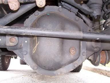

Been getting alot of questions again lately about "what axle do I have", well here ya'll go....
TJ / LJ model axles identification...Stock factory axles.
(LJ is the longer TJ body model)
ALL TJ/LJ models come standard with a D30 front axle ALL.
Picture of D30..
ALL LJ models come standard with a D44 rear ALL.
Picture of D44 rear for TJ/LJ models...
