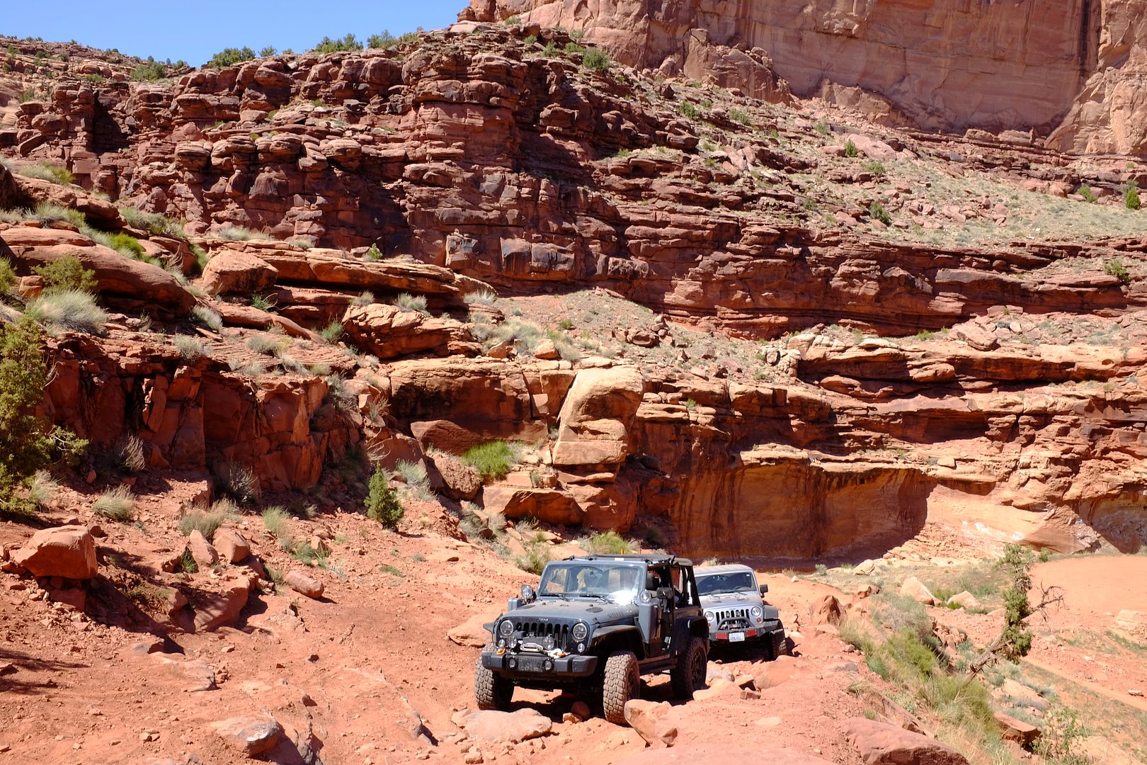

Ascending up out of Kane Creek Canyon at the end of Week 2 of a 3-week trip to Moab last year. Drove out from the east coast. 1.5" Redrock spacers, 285/75-17 KM2s, OEM Willys wheels. No problems so far. Spacers have been on for about 18,000 miles.
