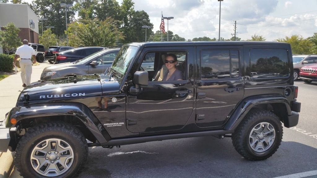

This build started as an attempt to meet 2 different needs -
1. Build a vehicle that can long run replace a trailer only 4runner as the family wheeler, and
2. Be my wife's daily driver and something that both her and the kids enjoy every day.
To meet #2 we started with a 2015 rubicon with way too many extras (who knew you could get leather seats on a wrangler).
How we bought her -
