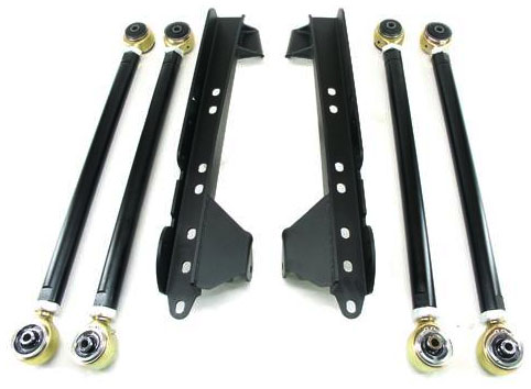

Sometimes I wish I went with a kit. Like the teraflex long arm or the Rock Krawler kit. Though I do kinda wish I went with a bolt on longarm frame mount from teraflex. Would have taken out all the guess work for finding all the right angles. Even getting a rear 4 link frame mount from gen right would have been good to. But they want 250 for just frame mounts. I got all my rear suspention mounts for that amount. Another thing I should have probably done was get adjustable upper mounts, so that I would be able to dial in my anti-squat.
Teraflex longarm bracket. Just wanted the bracket not the arms. My arms are stronger than these at 2" OD and 1/4" thick. My uppers are the same strength as these. If doing a triangulated rear you'll probably have to cut the rear upper mounts off and reweld them at more of an angle.
