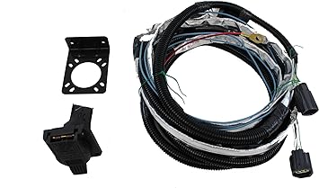

I need to pull a trailer occasionally for work and cannot connect the light plug. I need a 4 to 7 pin adapter but am unsure what to get. Do I need to get one that I can mount there on the back bumper, or is a small not-mounted one that I have to take off and on work just as well? Not sure if this is a dumb question with “just my preference” as the obvious answer but just wondering what other people do to get around this.
Typically a trailer with a 7 pin plug is going to have brakes on it. You will need to have a 7 pin on the vehicle to operate those brakes. That is why you don't see ready made adapters going from less to more pins because it means you can't use the brakes which is a big problem if the trailer is of any real size. That is why you see the 4pins on small trailers because they aren't heavy enough to require brakes and can rely on the stopping power of the vehicle alone.
The correct answer is to install a 7 pin harness on the jeep and get a brake controller for it. Mopar makes a kit for the JKs.
I agree with DiamondMox, the best way to do it is to do it right and install a full 7-pin on the Jeep and not try to make some way to circumnavigate it. Jeeps are not good tow vehicles as is and depending on the size and weight of the trailer you most certainly will want the trailer brakes fully functional.
And most importantly does it have electric brakes. Not all trailers with a 7 pin connector have electric brakes. I had a 7 pin on a utility trailer for years so no one would ask to borrow it. When I sold my PU tow vehicle I converted it to 4 pin.
But if you install a 7 pin socket, you can either keep the 4 pin as well or use a short converter.
