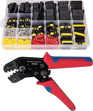

Here's an even mnore complete depinning kit
Here's a Weatherpack style kit complete with depinning tools
And here's one with the crimping tool. The crimping tool makes a difficult job easy.
