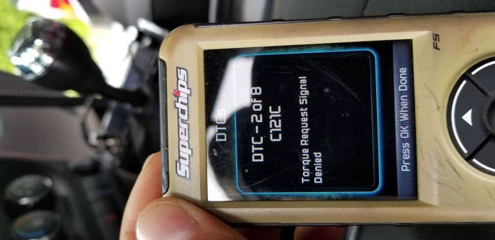

Hey guys i got a 2013 rubicon unlimited manual shift, 4.88, 4.5 in lift, 35x12.50 tire alpine control arms teraflex track bars front and rear and adams 1350 driveshafts.
Aligned by someone that specifically deals with JKs.
Driving on the highway for any amount of time my check engine and ESP lights come on and my jeep goes into limp mode. I get 2 codes shown in the pictures. It makes it difficult to shift by delaying my gas by a second and killing power (engine doesn't keep accelerating, i HAVE to shift) after i reach certain RPMs. Also as I let go of the gas the jeep bucks on me so i have to put my foot on the gas and lt it off very slowly or press the clutch in to put the engine in neutral.
Does anyone have experience in this and if so how was this situation resolved? Its been going on since i put the new gears in. I have a flashpaq 5 and reprogrammed the tire size and gear ratio. I'm getting to the point where I'm about to sell this dang jeep.

Hey MMello13, how long after you put the gears in and reprogrammed did this start? This is the only thing that isn't adding up to me. It might be just unbelievable poor timing of the situation or it MIGHT be something else related to the work you've done. Was it instant the first time you took it out or did you have a few weeks of problem free driving?

If i recall correctly it came on immediately. Sometimes it comes in after driving 5 minutes on the highway and there's been times since that i drove to lincoln new hampshire and back and never saw it. That's a 4 hr drive each way. So my guess is that its a wiring problem rather than pressure problem considering the randomness. Also praying the same. Lmao its been about a year and no one can figure it out but i don't have money to throw away on the dealership.
