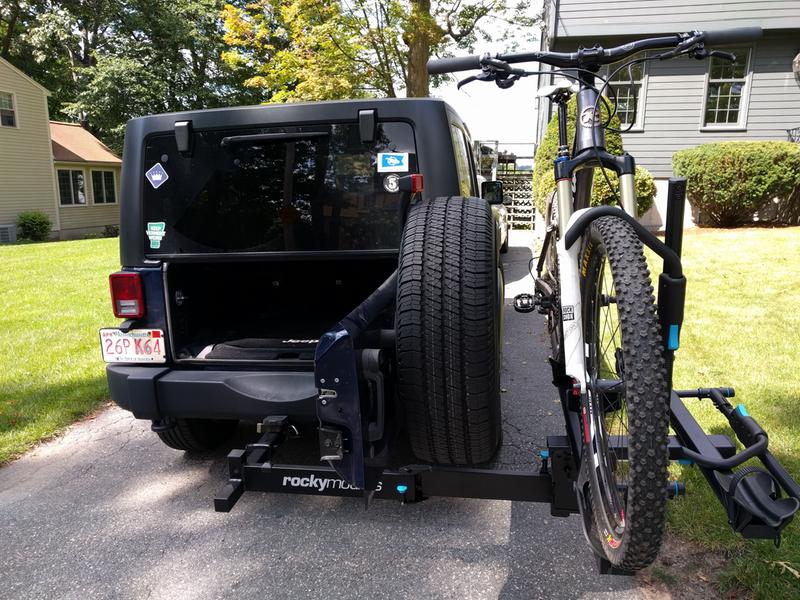

I got a first hand look at a friend's RockyMounts Backstage swingaway, and it was definitely nice. I ended up going a little different route. I wanted something more modular. I started with the Kuat Pivot. The 2nd gen version has the 'handle' mounted horizontally to lessen the chance of interfering with the spare. I love that I can use it with any 2" or smaller hitch mount accessory. And the Pivot acts as the hitch extender so you probably won't have to worry about that. For the rack itself, I liked the RockyMounts bike retention design, so I got the Monorail Solo. I will very occasionally need to carry a 2nd bike, so I also got their Monorail Add-on rack to make it a 2 bike setup when needed. I don't have any side shot pics but it definitely doesn't stick out as far as some others. I did run into some compatibility issues due to the integrated hitch on my bumper, so that is something to keep in mind. I actully had to change my spare mount to get the thing higher. And partially because of that; but also since my rack is designed to work well on smaller vehicles, so it has a healthy bit of rise built into it; the whole set up with a bike on it is pretty tall. Like won't fit in the garage tall. I may change to a different rack because of that. If I do, it'll be to a 1up USA system.
