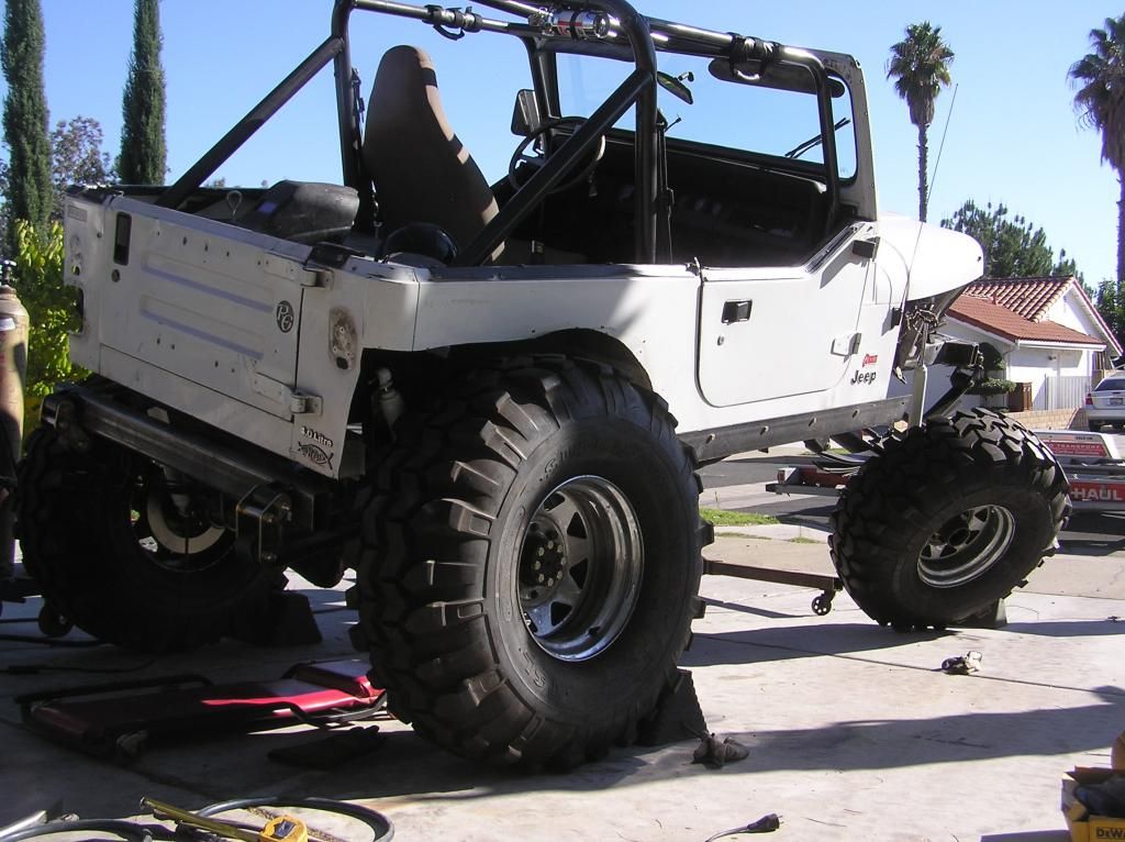

Did the work on the YJ for a friend.
My put put Jeep is a TJ with 1 tons
Took 11 months of my life to built, but I have so much fun with it, that it was worth every dime and every minute.
orogrande20 by aartjestaartje, on Flickr
