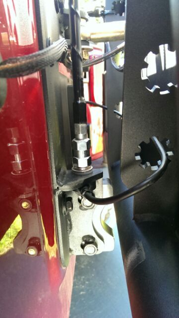

Not sure if this is worth a separate thread. But where are folks mounting a CB antenna on the Ace rear bumper with tire carrier? And what mount did you use? I would prefer to have it off the tire carrier as opposed to the license plate or a forward location. Also, with a mounting in that area, did you go with the 3 or 4 foot stick?
#51 ·
Same 4 foot stick I had previously and due to this mounting spot its lower than it was. Gate it open in the pic, thus the gap between the carrier and the tailgate cradle.
All I did was drill a single hole through that piece of metal that comes standard on all the ace pro's with carrier. Only downfall is when the gate is closed the antenna is very close to the carrier so any big bump makes it clank into it. It doesn't bother me anymore, but did at first. I run a firefly which are more flexible, not sure if a standard firestik would flop around as much.
I can't take credit, I actually got a hold of ACE and asked if they had any recommendations since the previous mount I had wouldn't work with this bumper. This is what they suggested. I told them this should just come pre-drilled to make everyone's life easier since it was kind of a pain in the ass to drill with everything still mounted.
